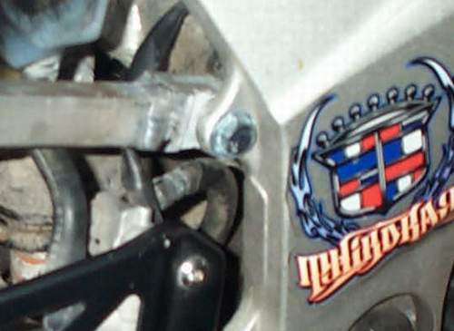

Old Feb 1, 2005 | 12:46 AM
NEP's Avatar
NEP
Posts: 239
From: Phoenix
NEP is an unknown quantity at this point
Re: Reinforce Gixxer Subframe
hope this pic helps, it's the best one i could find...
subframe bars

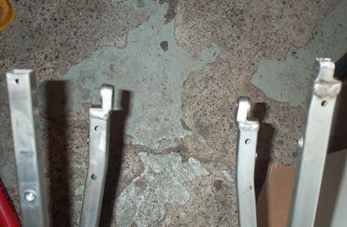

Old Feb 1, 2005 | 01:20 AM
Fiks's Avatar
Stunt.ca
Posts: 343
From: Montreal, Canada
Fiks is an unknown quantity at this point
My subframe tabs broke after a lot of abuse, if you're smooth they're not gonna break, I wasn't when I was learning so here's how I fixed them. it's way stronger than before and I never had a problem since then, and I scrape a lot.
1. both lower tabs are broken
2. cut the subframe to remove entire tab
3. find a piece of aluminum a bit bigger than subframe
4. grind it to be able to insert it into subframe
ID:	121129   Click image for larger version
ID:	121130   Click image for larger version
ID:	121131   Click image for larger version
Old Feb 1, 2005 | 01:22 AM
Fiks's Avatar
Stunt.ca
Posts: 343
5. have it weld, grind it to make it fit, drill it ... et voila.
