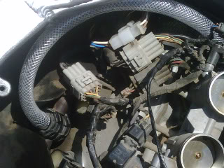

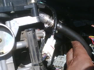

I just wanted to see if you guys could double check this
and I was reading put a screw somewhere but where
Read this. do what the man says. Took me 10 mins to do mine last night
ok there are some 636 owners who have read this whole thread but didn't get it so imma try and explain this a different way
see the big hose in the picture above ,the one that has a black hose clamp on it and it isn't connected to any thing on one end ?
that hose needs to be connected to the big hose with the gold hose clamp on it in the picture below ,it also isn't connected to any thing on one end ..
ok now there is a little vacuum line in the first picture that goes to the back of the clean air valve thats the black plastic thing that the first big hose i talked about is connected to you need to take that little vacuum line off the clean air valve and put a long screw in that vacuum line and thats all you have to do to the hoses and lines..
the only other thing you have to do is plug the holes left in your air box that the two big hoses you connected use to go to....
you can replace both of those big hoses with one long hose or you can connect them in a number of ways but the objective is to by pass the air box....

I guess I got it Ill just have to blow my motor
Old May 30, 2009 | 07:19 PM
  #471
Re: kleen air on my 636-good idea!
cant really tell from your pictures but if you bypassed the air box , blocked off the holes in the air box and disabled the pair valve then you got it

yeah I think I did it right because the bike didnt sound different
all I did was ran the hose from front to the back hose then I grabbed the lil hose to that t looking thingy and ran a screw inside it and blocked off the two hole to the airbox with screw and I think that it right?
Old May 31, 2009 | 12:22 AM
  #476
sounds right
