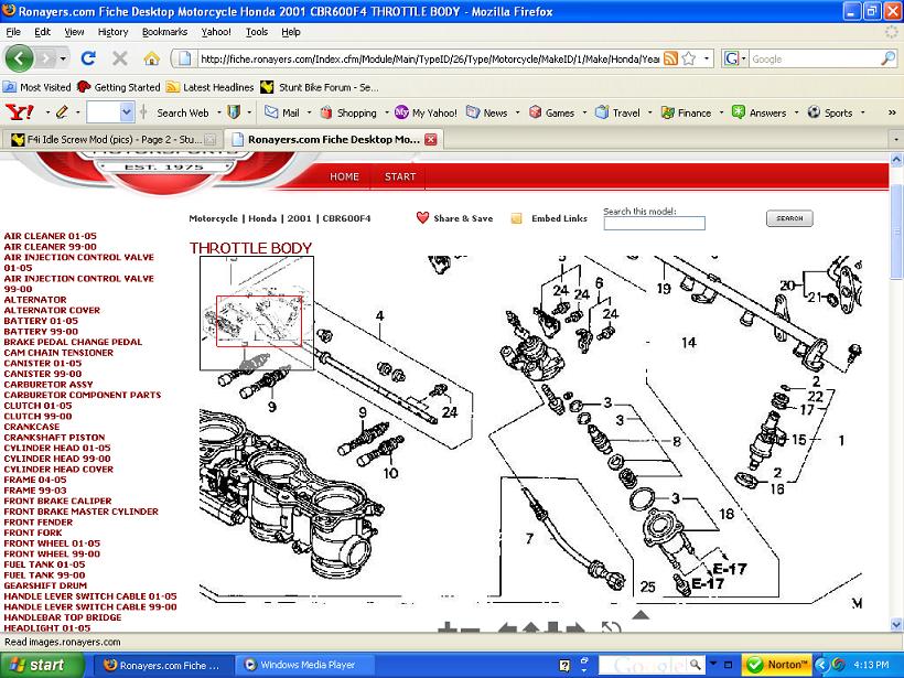

the stock wax unit screw. mine fell out and i dont know where to put it back in

Re: F4i Idle Screw Mod (pics)
Its Under The Throttle Bodies..you Need To Take The Tank/air Box / Throttle Bodies Off And Its On The Left Side...
any more details? have a pic maybe? thanks for the help!
its number 7
alrighty. ill look for it in that area. i just took off my airbox and tank to change out the plugs and i did this mod while its off. ill look for where to put the stock one back while its off too. thanks!

ok so i took off my tank and airbox to tighten my cct and im guessing the idle screw mod was pinched under the airbox so i did a search and the one on my bike doesnt match any of the pics.
Can you tell me where the hell this cable is goin?
Its the one to the left::
I read thru this whole thread and i just want to make sure it doesnt **** up the air\fuel mix... HELP ME OUT!!!!!!!
Im also guessing that the air mod isnt done either??
what other alternatives did you guys use for the CCT key??
besides making one like in the f4i clymer book?
HOLY ****! Wtf is that? That cable needs to go between the 2nd & 3rd throttle bodies (by the linkage) In place of the throttle stop screw that u remove as explained earlier in this thread. The cable u have is a homemade extension of the air/fuel adjuster which is what u DONT want. Find a stock one to put back in its place and leave it alone. Use ur new cable to adjust idle which actually opens the butterfly.
