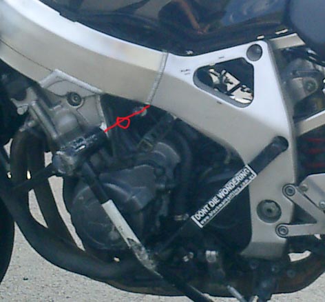

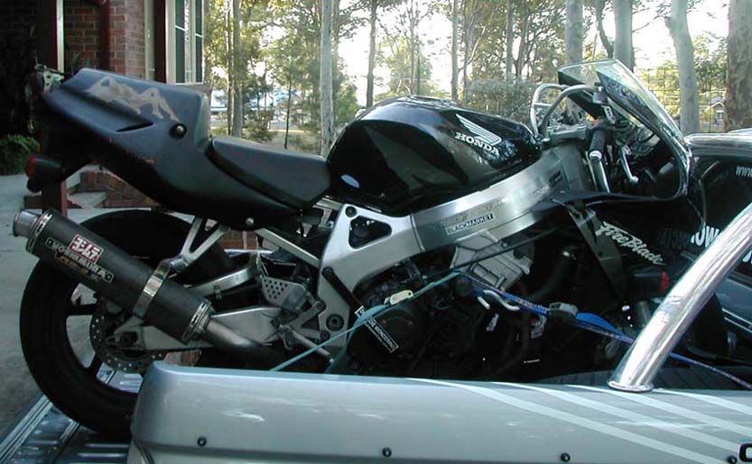

I got a 98 Blade, stock gearing, only a Yoshi pipe, but I usually practice with the stock pipe on so I can prac all day without the cops coming to move me along.
I have an FI cage but agree it WILL break my engine mounts if I dont change it so I'm gonna get a plate welded between the current mount and the frame to put the new mount thru as seen in the pic, which was taken after I binned it and it bent the mount!
I just put a 12 bar on today but I dont think I will scrape for a while cos I dont get to practice too often. I'm in Aussieland so we are a fair way behind you guys
put some pics up when you get it so we can see.
This is my beast from Jan 29th and Neddy who wants to learn 2-up stunts with me!!
She loves Stuntin.
Note the cage.
