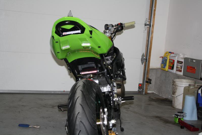

got the *** end all buttoned up with the si roundbar and an undertail that came with the bike. the brake light is just a led light I had layin around

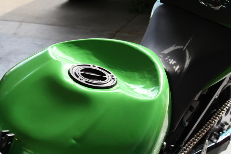

Next is the tank, I'm leaving the fairings stock green and I want the tank to be clean with no chipped paint. so I decided to have it powdercoated which means my tank can have no bondo. I was pleased with how it came out other than it is a cali emissions tank so I didn't pound the cap down very far because I was afaraid of breaking all the vent lines inside. I first had the tank sand blasted to remove all paint. then mounted it up and started pounding away with a small dead blow and 10 minutes later I had the best dent I've ever done.
After powdercoat I was worried how it would look. I knew there would be little hammer marks but its not too bad. I still have to cover it with stomp grip anyways. it's a little lighter than kawi green but I can live with it.
Here it is mounted on the bike
