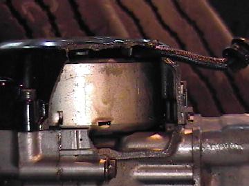

Guys,
My bike is pissin oil from behind the front sprocket cover, I pulled the cover off and it looks like it could be comin from either the front sprocket shaft seal or the clutch rod seal.
Is there any other place it might be comin from that Im not seein? I gotta get this **** fixed b4 NY.

Tried to change the clutch push rod seal last night....
Broke the lip that holds it in....
need a new damn motor now.

= major surgery tonight.... all night
swap out mid case wit blown motor case
b ready for LI by 8 am
gonna need beer 4 this one

Originally posted by gman_gsxr750
Sorry, to hear about that. Casey just bought a motor for his gixxer off of e-bay for cheap. Works good except for the slight damage in shipping. Make sure it's packed well and you might be able to save some dough. Good luck.
THAT HAPPENED TO ME TOO, got my motor with a broken stator cover and a chunk outta the case. ended up getting most of my money back and and jb welding the case together
