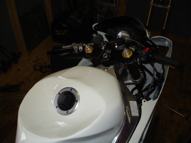

so im officially gonna try my first full Blown tank dent.I want to do a O-town dent cuz thats what my last bike had which im used to.Alot of guys are saying the phonebook method is easy but what exactly is that way.Im doing it to a 04 636 tank.here a perfect tank that i like and wanna try duplicating.How do i get the gas cap slanted in like that?
ANy tips will be helpful.
Thanks

thanks for the help guys.Ill make sure i take my time and i guess not take the cap off.I guess my question is how do i get the slant going involving the gas cap to like the one on the white tank pictured.ill cut the splash guard out to.i put gas in the bike today for the first time and saw that in there and was like WTF.last bike didnt have that and it splashed gas back out on my tank.i wasnt to happy.

yea if i could redo it i would cut mine out....but do not take the cap off and start at the bottom of the cap and work in a U pattern
