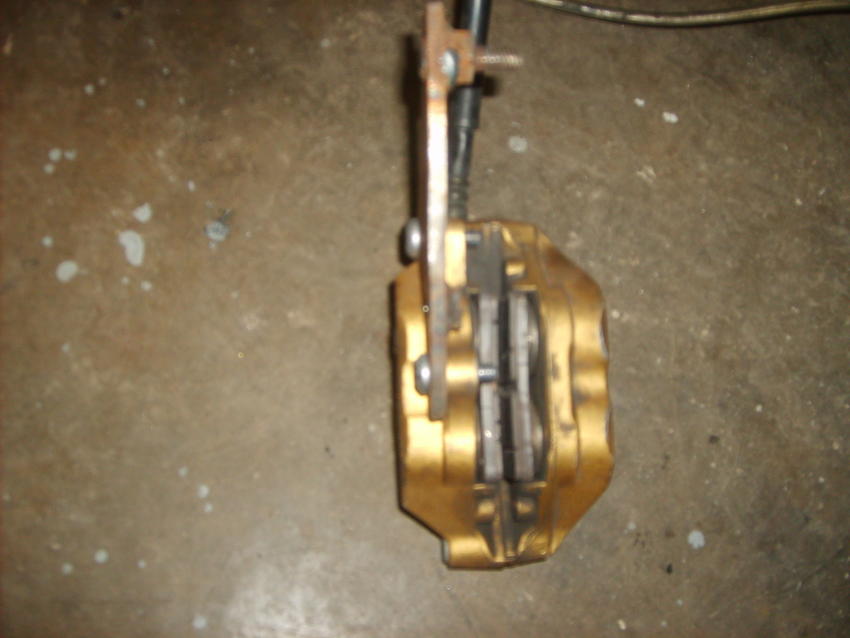

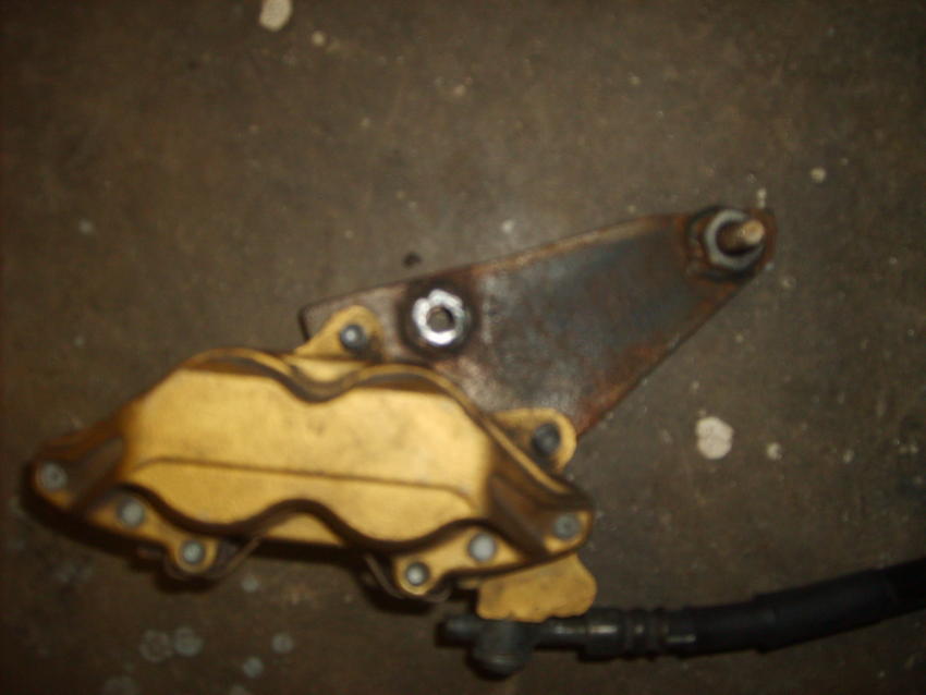

I bet.... I really like my footie so may try something a little different but it's nice to see what it takes to mount that 4 piston on it.

How does the foot brake feel on that 4 piston?
I like it
you dont have to push as hard to get the power. it takes a couple wheelies to get used to, thats really it.

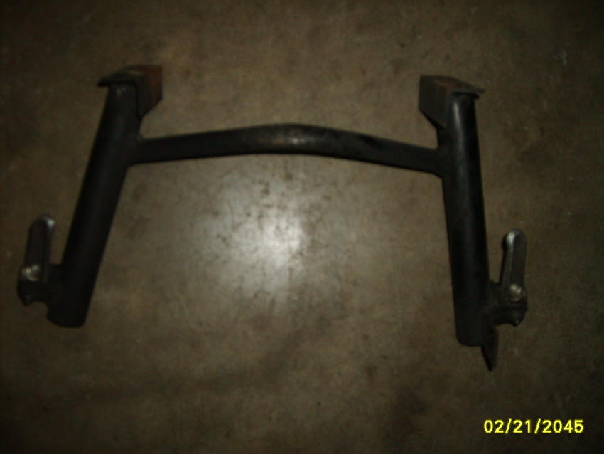

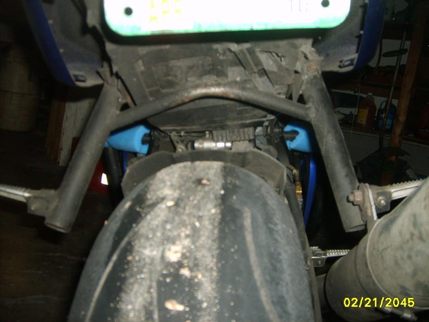

Here are a few more pics of my bracket. The home built sub cage looks good painted.

r6 i like the subcage its clean, i made my own as well, i just ran a bent tube in betweenn the rearset and mounted 1 inch solid steel pegs. works great and its strong as hell! i also welded plates down the leanth of my subframe.

Thanks shifter. Also i've found on the r6's that if you exhaust clamp your bar to the sub they don't explod so easy, mine has lasted for some time now. I have ran steel plate to the inside and bolted it to where the sub bolts and conected the bar via clamp's on a friends r6 and that **** is diesel. And he Gorrila scrapes that **** HARD.

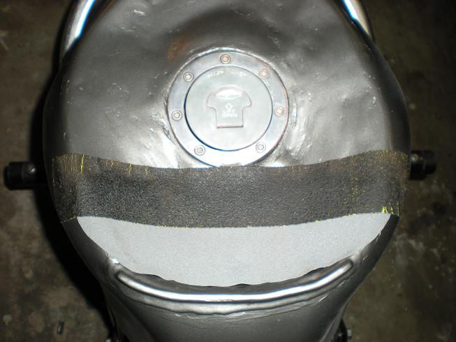

I jb'ed a lip on my tank and that **** is so nice now cant wait to practice some spreader O's, once I finish re-bondoing and painting my tank I'll post some pics
