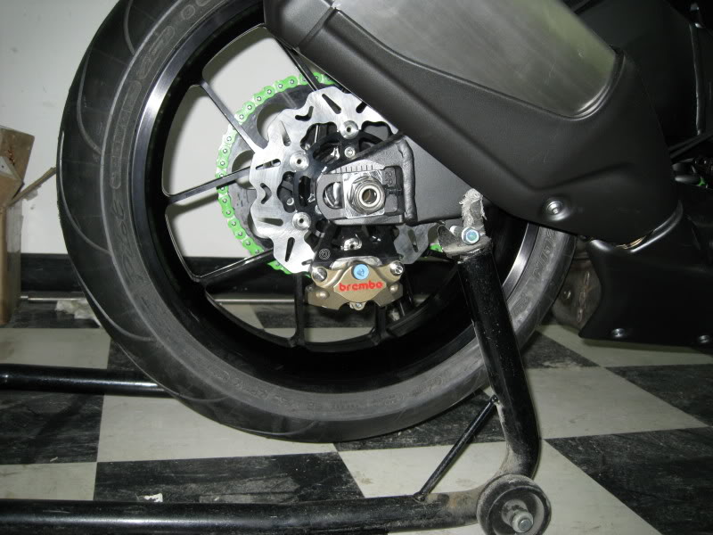

Im trying something new as far as rear calipers on my 09 ZX6R....
Brembo 2 piston caliper, with a floating rear rotor, and a 13mm Magura master.... It looks the ******* part thats for sure, but I'll let you guys know how it actually works...

looks ******* sweet and i dig the green chain i wantone for my bike in 525

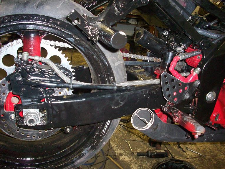

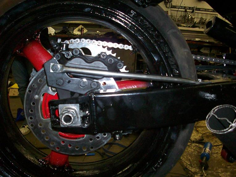

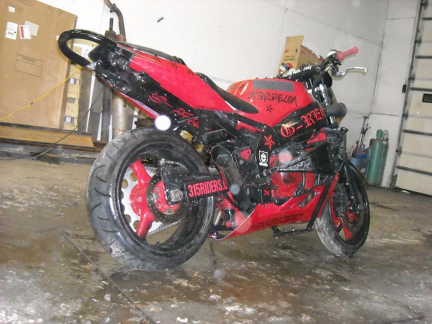

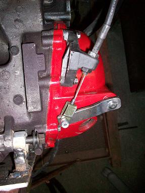

i personally would LOVE to see a durable brake master res cup. i actually used a stock f4 front master and sealed the outlet, took the lever off, mounted it in the center of the db bars and drilled and tapped two barbbed fittings one for each master.....works greaaaaat. I also fabbed a bracket like r6 with a stock f4 front caliper (4 piston) and make it fit, contacts roughly 85% of the pads, works tiiiittts as well. I also made a longer clutch release arm for a suppppa easy pull, all good ideas for production parts. its a 98 ninja zx6r btw, with every ******* mod you can think of accept the circle training wheels.......

How does the foot brake feel on that 4 piston?

touchy, i really dont play much with the footbrake but i have a cbr 1000rr handbrake rean inline with the footy, and i USED to need two finger a some serious pull to lock it up, i can to a one finger easy lockup without even warming the brakes up!........
