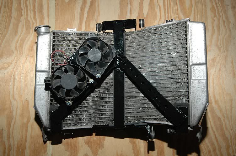

I run header wrap and engine ice with my fan on constantly. If you rape high idle (like me ), that isn't good enough.
The 03/04 radiators definitely have tabs to mount a 2nd stock 636 fan, but it adds a LOT of weight. You need a radiator cage to hold the whole thing. (you need a mounting cage with just one fan)
I know some of you guys have them, post up some pictures.
I'm working on one myself, I'll post some pics when I finish, but trust me, it will be ghetto-fabulous.

nice! does it work?....and are those cpu fans??
Old Jan 5, 2009 | 10:45 PM
  #56
Twite's Avatar
Posts: 1,338
From: Atlanta, Ga
Twite is an unknown quantity at this point
Re: 2nd fan help
I have no clue what they came from. Found them in a huge pile of parts at my friend's shop. I think they are automotive because they are 12v.
got it. just wonderin if they were sealed(waterproof) motors is all. all together nice job
