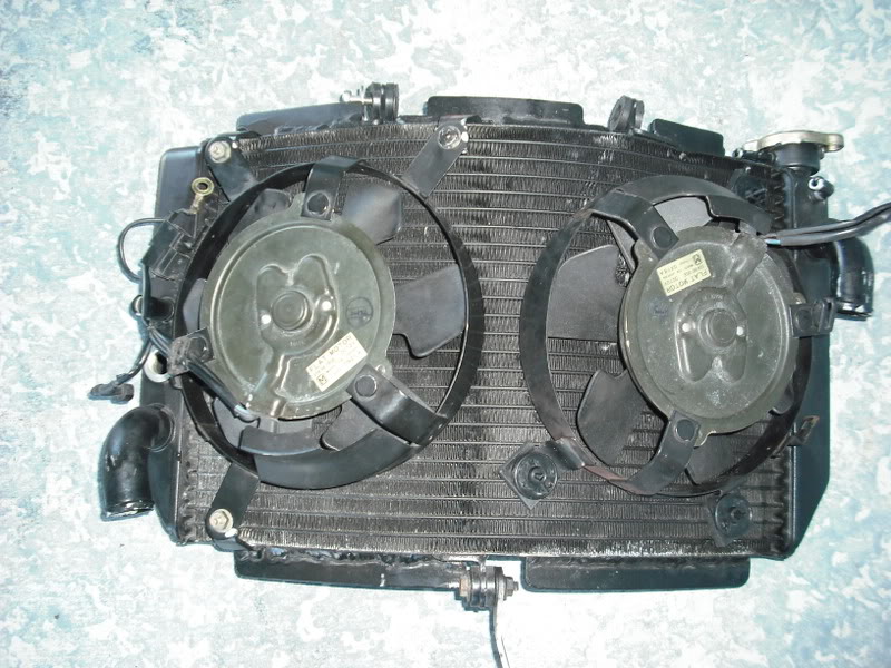

I saw the post about the cage but I went a different route, I have my entire cooling system stock with another fan wired directly to a switch. If you look I just took the stock F4I fan and flipped it and used Auto Zone universal mounts for the cooling fans. If you wire both of the fans at the same time your going to put a strain on the recharging system and kill the battery. I was doing this prior and now I can run cool all the time with short spirts from the extra fan and recharge at the same time. Should work the same on a 636, Engine Ice is great also!

Old Dec 24, 2008 | 03:54 PM
Re: 2nd fan help
i never liked those universal mounts , if they get loose they cut through the radiator

Re: 2nd fan help
i never liked those universal mounts , if the get loose the cut through the radiator
I had that happen in the past. Its best just to build a cage for the fan. It's not that hard to do.

im getting 2 636s in a week or so ill be making the cage with the second fan mount.when you put a second fan on you will want a cage with it cause the extra weight will cause havoc on the tabs. if your interested just hit me up
