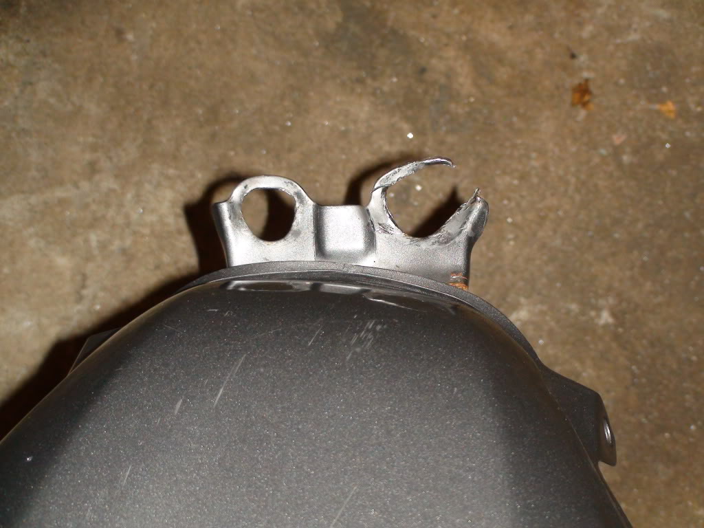

Toneth, the problem is the little L shaped mount on the front is bent forward, causing the actual tank to cover the top of the bolts. This probably happened when the tank got the dent on the bank.
Like I said, take off the rear mounts and push the tank backwards to bend that L bracket back and expose the bolts.
Here's a pic of my old tank which shows what the mount should look like sorta lol. You just gotta bend this piece back out to expose the bolts like infrolen just said

So basically just take those bolts out and yank it by hand? Lemme go try some superman bending steel ****.
yeah take the back bolts out to loosen the back of the tank and then try yanking the front back to expose the bolts by bending that bracket

He needs a set of cables and needs to bend that front mount...
I would NOT remove the rear bolts of the tank and straighten that way because then he might have a problem trying to align the rear mount back up..
If you notice the bracket stock has a nice little bend to it. I would put pressure on the TOP-FRONT of the tank and push it till i got it where its decent..

**** me. I can't get it to move for ****, and I'm a pretty big dude. Also it has no brakes so I'm just keeping it in gear and yanking... could that **** the tranny up? Oh, and one of the rear seat bolts was stripped.
