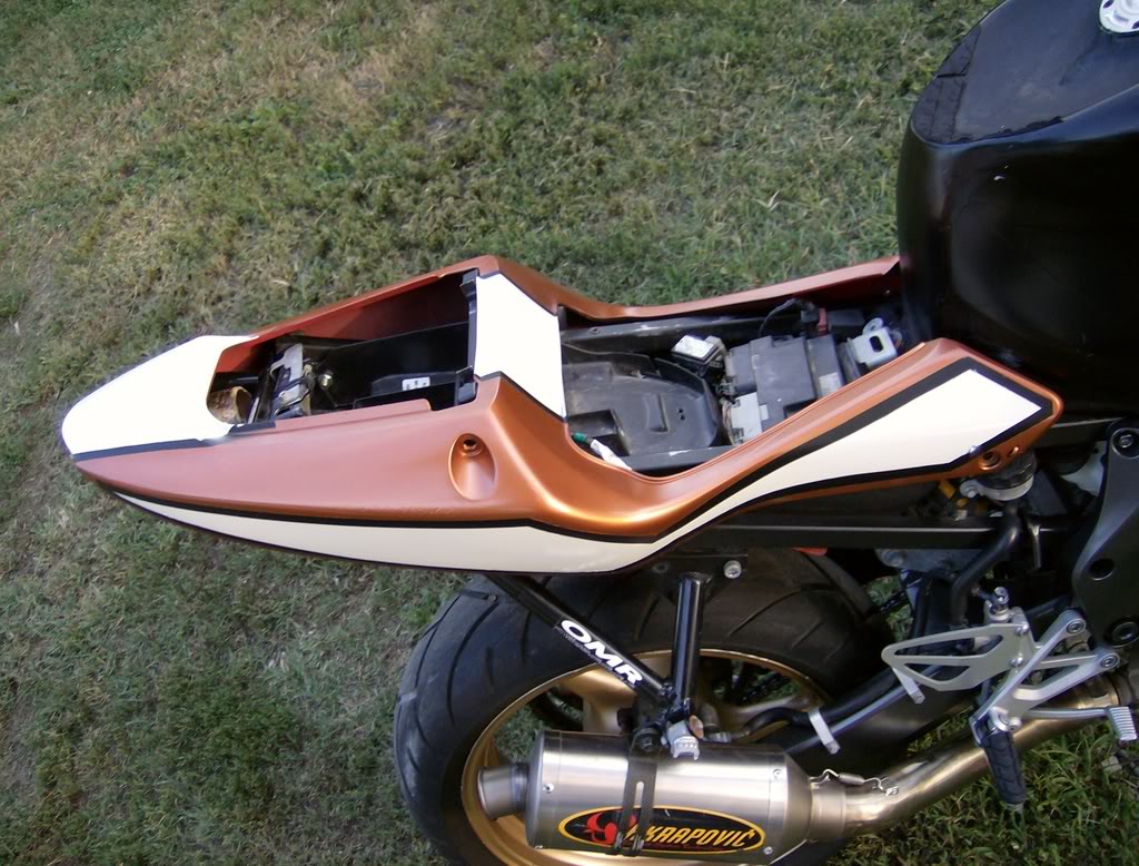

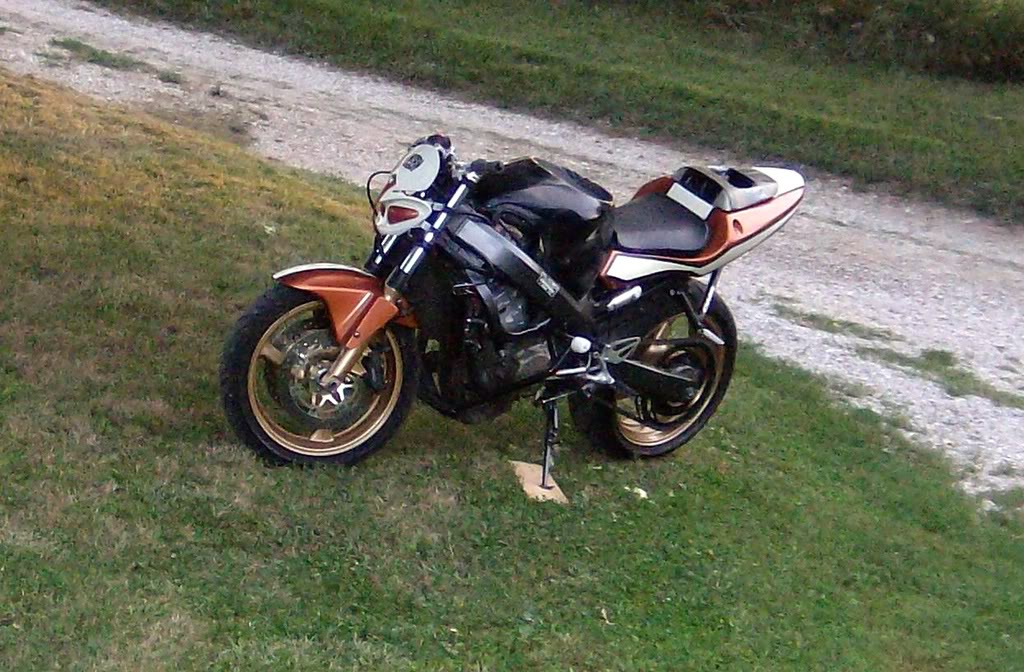

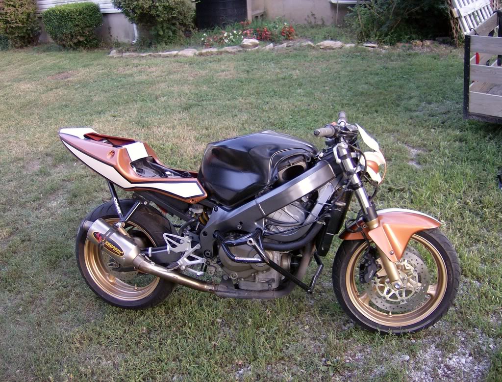

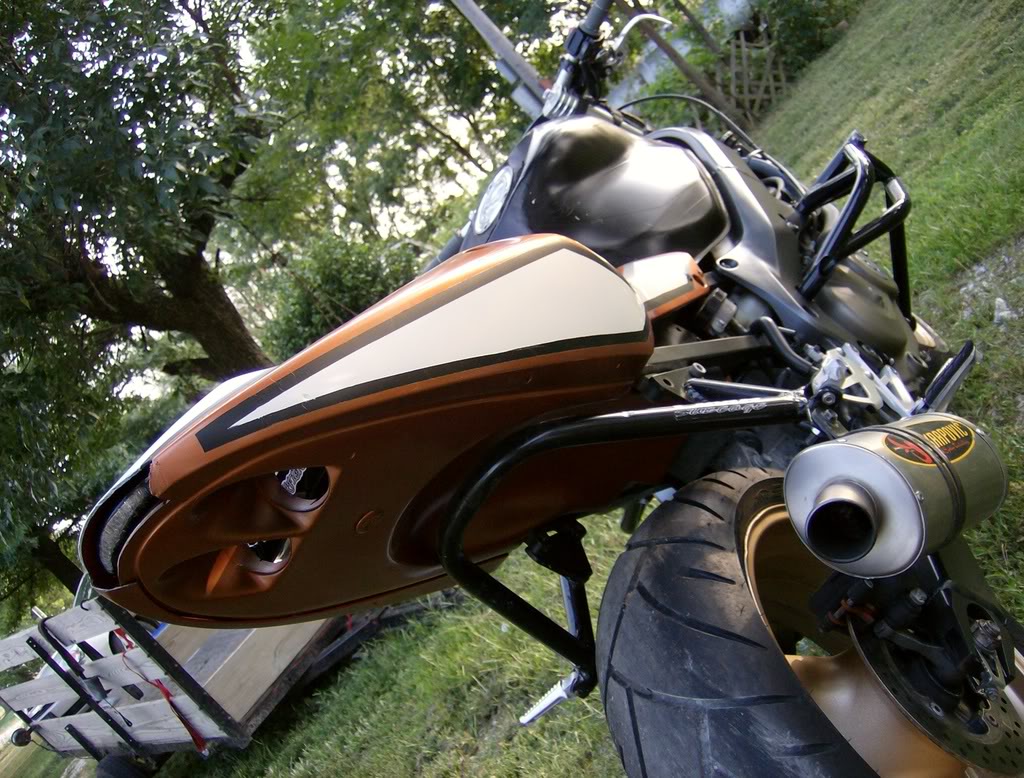

OK guys....Here's the good, the bad, and the ugly...
the good.... I got the tailsection done, and I'm out of paint for now.
the bad.... I decided against flames cuz it's ben done to death and I wanted to try to use lines and shapes to maybe make the tail look a little more svelte, or slim like my gixxer tail. I think it was a sucess and created the illusion that I was goin for.
Whatchya think??

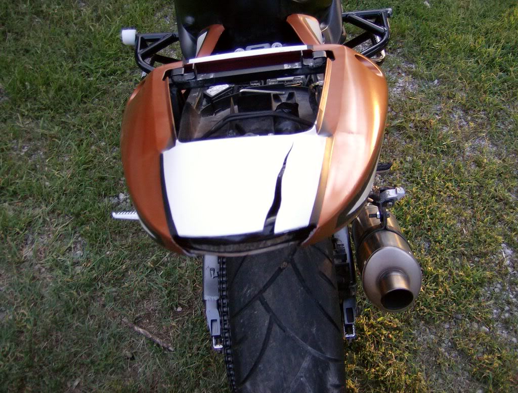

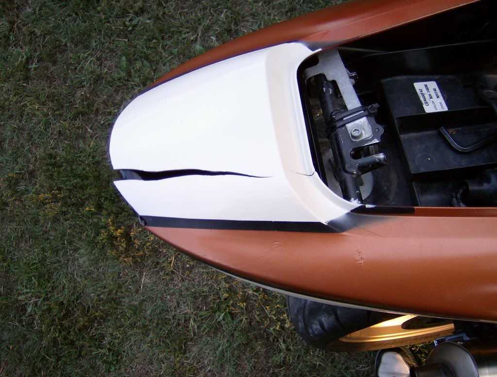

NOW.... The ugly..... I'm not sure WTF happened! I squeezed the tail section back on, went in the house and ate a plate of spaghetti... then came out side and a crack had formed right by the scrape bar!!! WTF!!! I was like OK... so then I tried to adjust it's position and look as to why it was like it was, and this was the end result!!! I'm not sure why it felt so damn tight to begin with?? IT came off like normal and went on a little snug, but I was afraid of messin my work up.....
I'm soooooooooooooooooooooo pissed!
I got it all bolted back up where it needs to go.. now I guess I just zip tie that end piece like stitches and paint them white, just like the sides where it bolts to the subframe are ziptied and painted too!! Could you guys see that??
This sucks.. what would ya'll do to fix it? I mean I don't care a whole-whole lot, I just want to get idle and NTH on lock by the time it starts getting cold out to be honest.. as long as the bike looks good on film (photo/vid) that's all that matters right?? LOL
If I can ride out of my scrapes and coast for 50-100feet also by then I'll be happy, and that's regardless as to weather my tailsection is in two or 37 pieces!!!
still though..... all that work and it ****** cracked on me outta nowhere...
IN that first pic with my seats on the bike... I took it from about 35 yards away, and it has that crack in it in that shot. Couldn't tell could ya?? It's pretty hard see it unless you get up on the bike, but still...

take the tail off.....squeeze that crack together, then fiberglass the **** out of the back of that area! Get Towliee's *** down to ur neck of the woods to show you the fiberglass skill..and you can show him how to lay down paint so his bike looks good inside 15 feet.....not FIFTY!!!

Fiberglass is pretty easy really, just messy if you drop it on ****
buy a 32oz bottle of fiberglass resin from walmart for like $15, you can also get some fiberglass matt there for cheap too (like $10), a box of latex gloves, a bag of foam paint brushes (like $2 for 12), and some plastic cups to mix the glass in
Then you just cut strips of the mat out, sand the back side of the tail with like 40-80 grit, mix up the resin, brush the resin on the tail, lay a layer of glass, more resin tell its SOAKED, more glass, more resin, more glass... After you get however many layers you want, smooth it out with your hands so there aren't any bubbles and all the mat is soaked in resin...
oh ya make sure you don't get the resin on ANYTHING you don't want it to stay on.. Don't get it on your hands, your hair, your carpet, the wall, your kid
It sounds like a lot of work, but its not bad, and it'll save your tail from breaking!
You saw mine where I stand, got about 15 layers right there lol.... Solid as ****! If your just wanting the tail to be solid so it doens't break from stupid **** like mounting it, then 3-5 layers over the entire back side of the tail, with 7-10 around where you stand, will make that ****** SOLID.. But don't put toooo much fiberglass, or it won't flex enough to go back on the bike!

If I was you I would fiber that crack closed and smooth that tail out.
