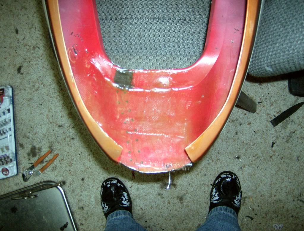

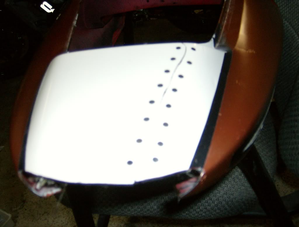

Thought I'd show how I fixed the tail section crack.. I found a small crack where someone had already tried to fix it before I ever owned this **** box, so it explains why the added pressure of the squeezing it off and on may have made it crack I guess.. but here's what I did and two coats of this **** and it's diesel as hell!
I drilled these holes for zip ties initially, since it was flappin every time I scraped and I cut it down some more just unevenly. but I just put masking tape over those holes and fliled them with resin on the first coat and layed the strips down on top like you do and that made little like resin pegs, or nails holding it together adding to it's strenght... I pulled off the tape and it was flush with the out side of the tail and the tape didn't stick to the resin at all....
now all I need is do some minor finish work with some glazing putty, sand, mask the rest of it off, plus paint that white, and it's good as new.
Imma go the extra mile though and do the section between the seats though and see how good it does for seat standers like that instead of buying a tailsaver.
I don't see why it wouldn't work, cuz I got one of my friends' tjat did that to his tail and it's pretty damn tough IMO...
