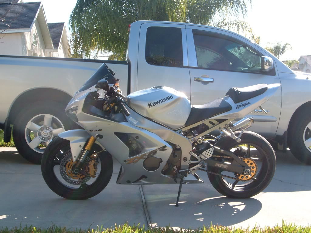

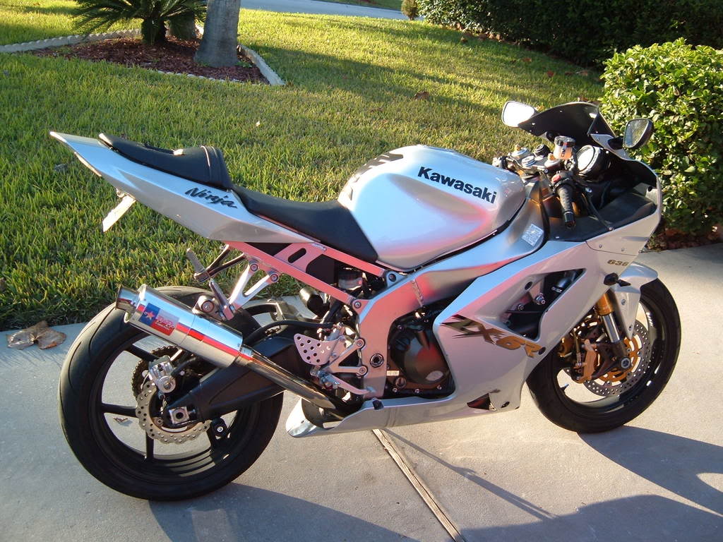

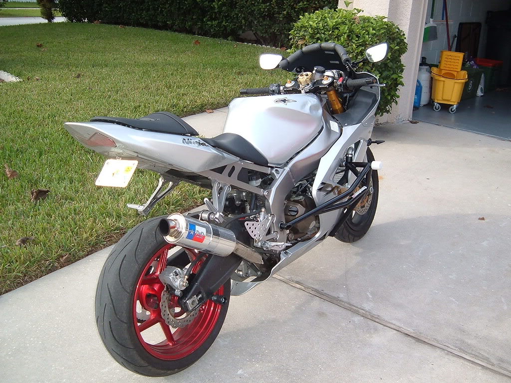

Use the 05 shock because the res on the 03-04 will get the **** smacked out of it when you clutch up. Willie found that out the hard way. Here is a few pics of mine.
