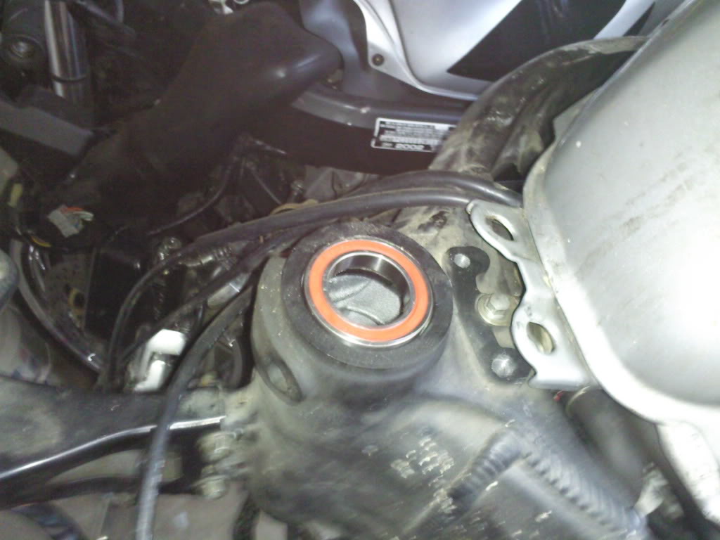

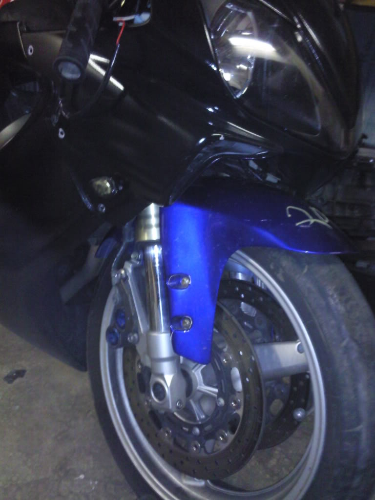

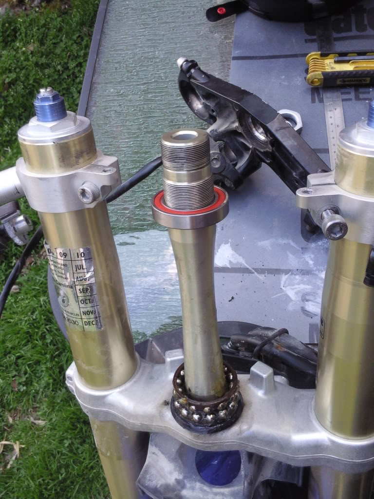

thank you all this site was great help i just installed a r1 front end with a sealed bearing and new tire all for just $370 $300-r1 front end,$30 sealed bearing,$20 used tire only had 200miles .,.,.,.,ppl get the sealed bearing my bike turns very smooth

use the complete R1 triple. The bottom triple will drop right into an F4i with no modding needed
For the upper bearing you need a special one. See the pic of the box with part # (it's a 1-piece sealed bearing). Get it, remove your upper bearing race in the frame, tap in the new bearing and you're done.
Don't use a NSK bearing..spend the extra dough and get an SKF.

eeek! that high mount and those forks stickin out the tripple scare me
