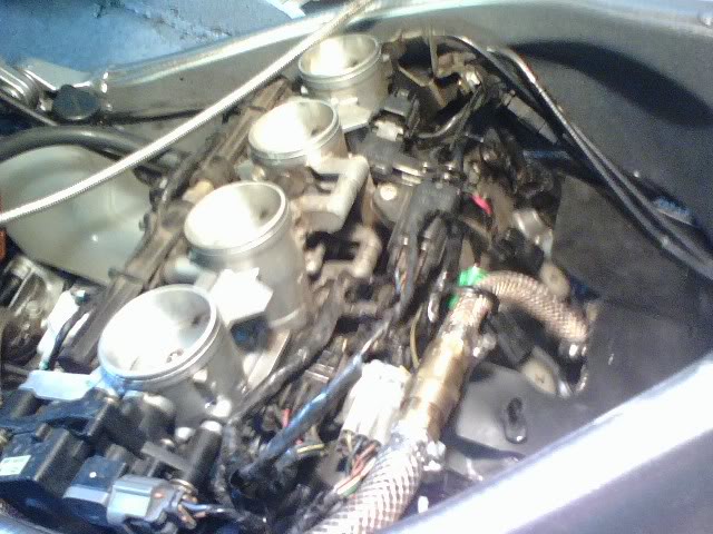

Ok. So I checked the vacuuum lines i think. The line connects to the front of every throttle body in the pic. The lower right is the TPS sensor, and secondary sensor. JB, you say that there is supposed to be a vacuum line running to the sensor too?
there is a sensor right in front of #2AND #3 THROTTLE BODIES. On the bottom of the sensor there is a vacuum line plugged in. if it is knocked off it will do exactly what u r talkin about and the one in front of #1 throttle bodie will not have a vacuum line. hope this helps
