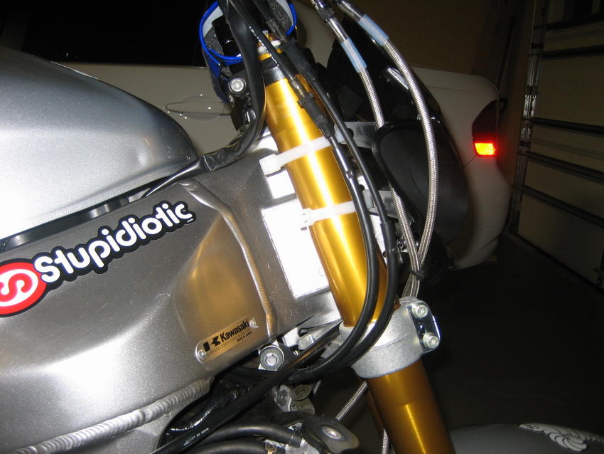

they clear the stay so much, i dont think it would on a regular stay and regular screen but i have a short stay and cut screen
my hand is in the pic just for a reference as of how much room there is, its really ridiculous to how much clearence there is

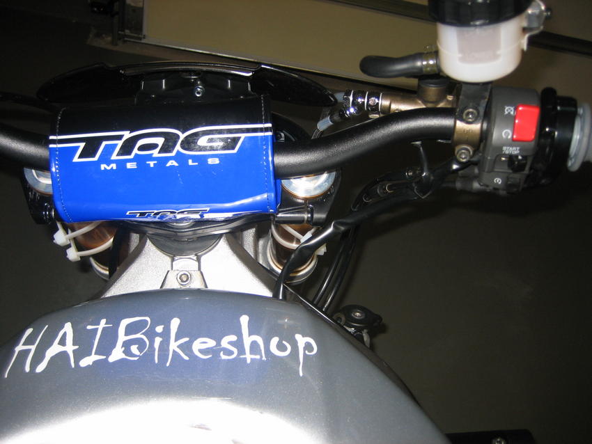

How i ran my cables works great no binding, everything is free
