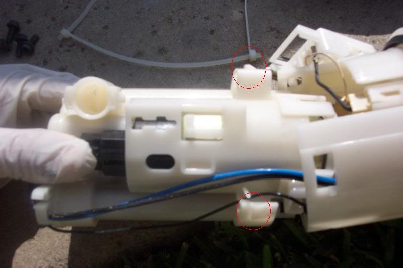

Ok so i found the hardwire to the camera and was able to get the pictures. Here is what i saw when i took out the pump lol
These are the steps i took so this wont ever happen again
Filed down these tabs to make some room..

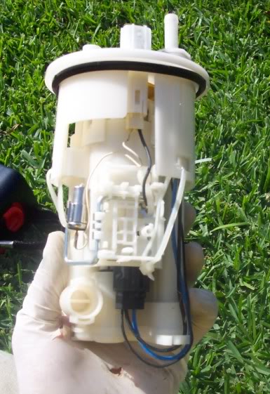

Drilled a hole here
And zip tied the **** together. I had to cut the tab on the sensor bracket to make room for the zip tie. If you look closely its to zip tie on the right
and Presto. If you don't file down the tabs, the zip tie will create too much of a space and the pump wont fit into the tank. Easy fix for a common problem. Hope this helps fellow r6 riders.
