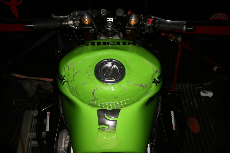

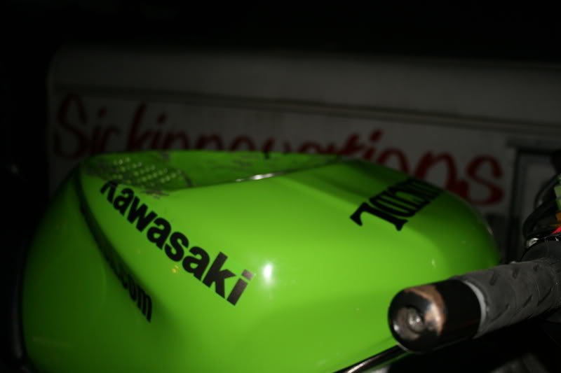

Here goes nothing. who thinks it is going to leak

Re: 636 tank leaking
lol gas ***..id take that cap off and get a shet of rubber and make a new if not 2 gaskets with a razorblade and try that ...my friend did my tank on a gixxer and that what had to be done
thats exactly like my dent... thats kind of werid....
you cut the splash guard out too?
so are you saying its going to leak on my *****
it might
if it leaks, jam quicksteel between the base and tank. I only did half way around the base and my ***** feel awesome now!!!!!!:YEAH
mine leaked out of the drain hole under the cap base.. quicksteeled that and it was money... and i put a rubber ring around the stock gasket so it would push down harder...
