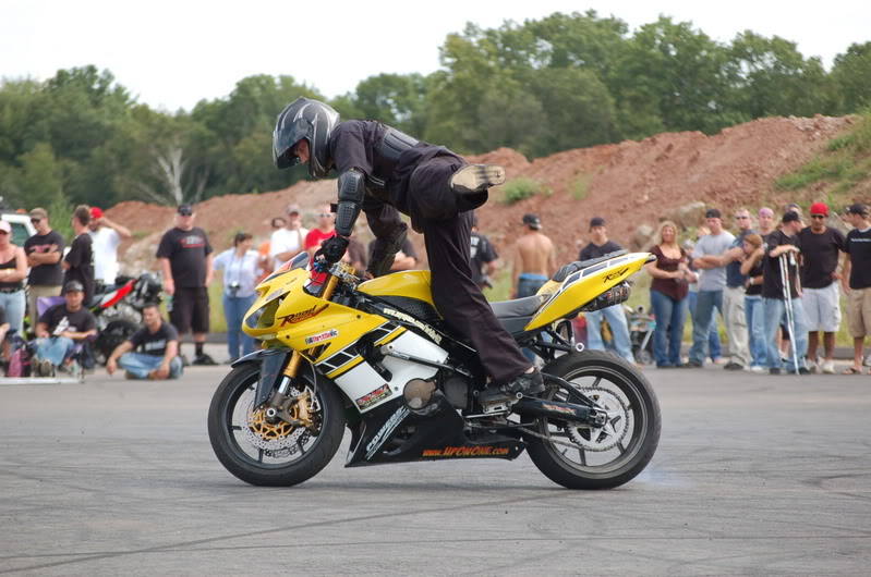

post up some pics of your forks from the side i am curious if maybe you have 03 04 forks on you 05 06 ..
maybe the person who owned it before you switched them out for what ever reason
Old Nov 4, 2007 | 01:11 PM
Re: 06 636 Faulty Forks
well this sucks cause those sure look like 05 06 forks....................
i just put a set on my 03.
