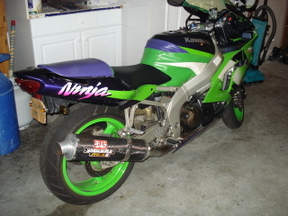

so i just picked up my project stunter. 99 kawi ZX6r. picked it up for 1400 dollars. i think it was a steal since there is nothing wrong with the bike just the fact that it doesn't have a title.
any ideas and suggestions on what i need to do to this bike to make it a good stunter. this will be my first big bike stunter, iam used to the fiddy.
i def want a cage and rear handbrake set up, gearing and all that good stuff. any suggestions.

youd be better off selling it and getting an f3/f4 . its gonna be hard to find parts for that year

those ZX6R's are good stunt bikes, just gotta watch out for the frame crackin were the ram air tubes go in (neck of the frame) im sure they would be just as good as a F2/F3 if you just get that problem sorted...
Old Sep 9, 2007 | 05:36 PM
Re: 99 ZX6r piece
make sure your motor mounts are tight ,that is what usually causes the frame to crack ......ok that and mouse trapping spreaders..lol
Old Sep 9, 2007 | 05:39 PM
Re: 99 ZX6r piece
and when you put a cage on it remember to tighten the motor mounts after a wreck because when you crash with a new cage they tend to loosen up after the first few crashes
