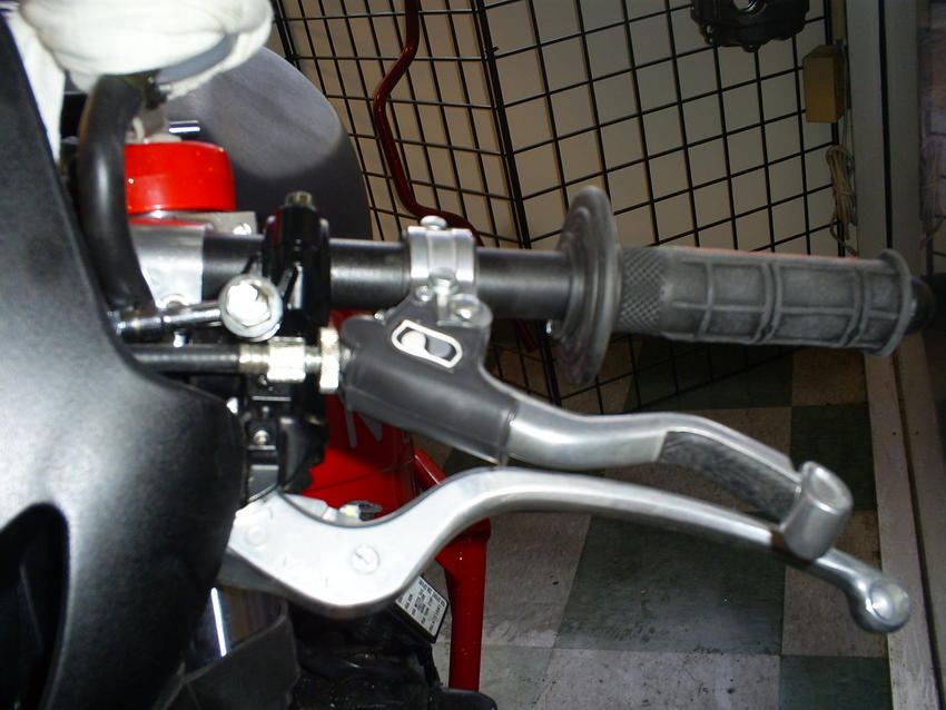

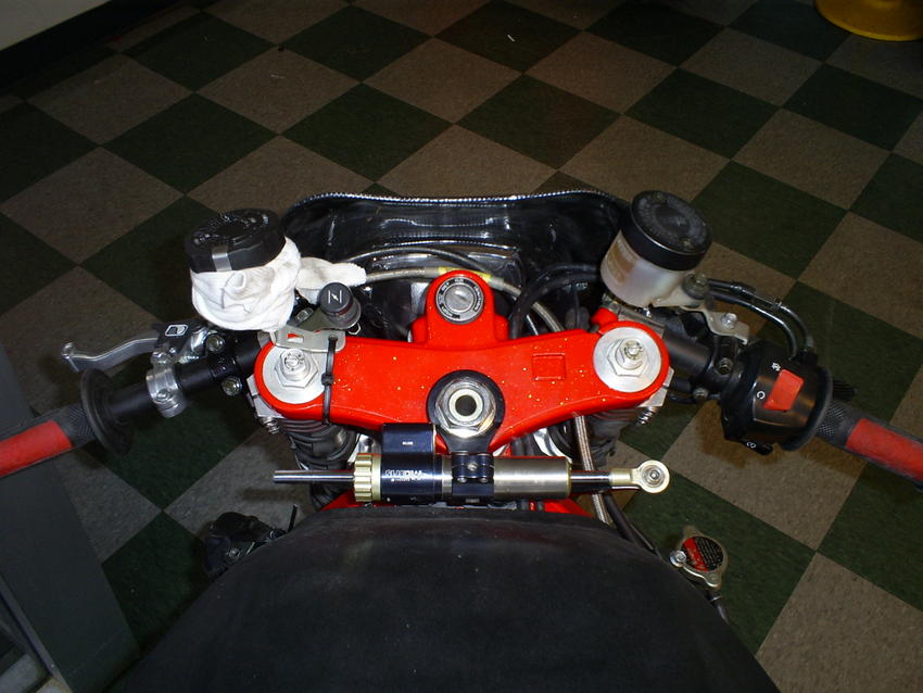

Old Feb 24, 2007 | 01:38 PM
punishmentcycle's Avatar
Joined: Aug 2006
Posts: 2,092
From: hartford ct
punishmentcycle is a decent person
Re: setup (brembo/FI clipons/msr raptor)
different clipons but just as long.this is the most comfortable setup i've had.i just cut the clutch lever down and now it's golden

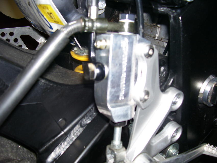

Old Feb 24, 2007 | 02:26 PM
here you go.
Name:	smallest 4 piston.jpg
Old Feb 24, 2007 | 02:30 PM
jbstunts's Avatar
Joined: Jan 2007
Posts: 2,027
From: blackwell ok.
jbstunts is a decent person
here you go.
thats sweet:YEAH how do i get that? oh and the brembo is a 1 finger type of deal, if not you have air in line

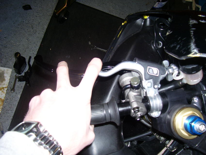

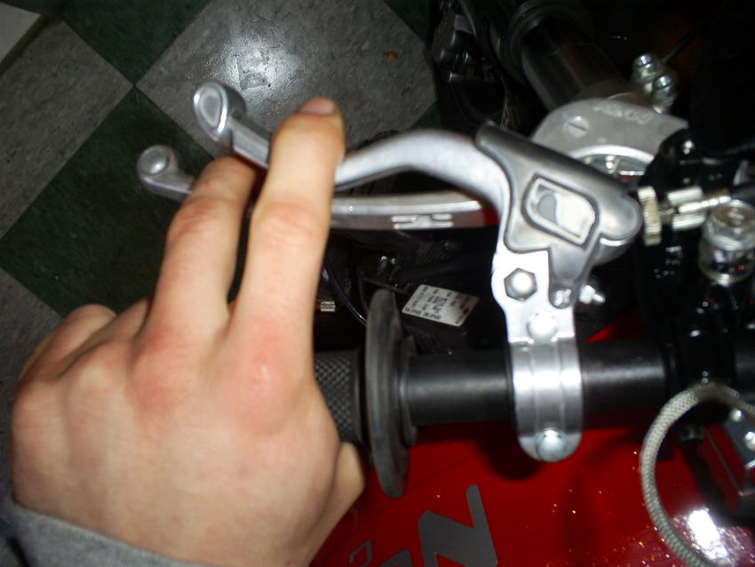

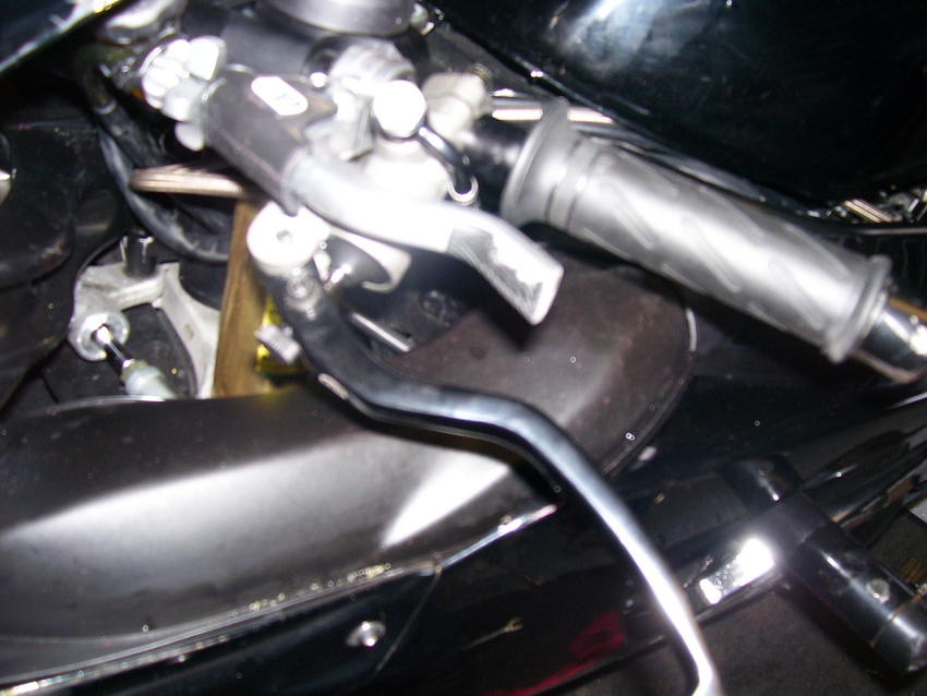

here it is:
ID:	189407   Click image for larger version
ID:	189408   Click image for larger version
ID:	189409   Click image for larger version
Old Feb 24, 2007 | 02:33 PM
dean i would cut that lever or it's going to brake when it hits the ground ..
or at least cut it half way thruogh so it will brake where you want it to so you can at least still ride for the rest of the day...
in the third pic, where the open end wrench cross's the lever is about where i was going to cut it-
