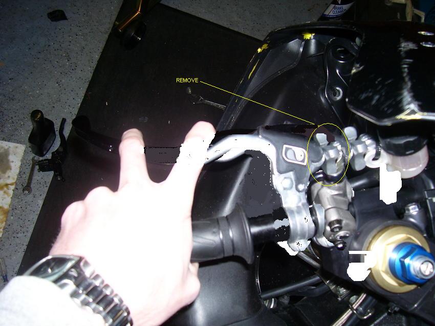

dean that setup sucks... u wanna be as far out on the hb as possible for the most leverage.. run clutch on the outside, brake inside.. and cut the clutch lever... i will tak some pics of mine and num2's later today.. he has the brembo, i have a gix radial
yo where these pics at? i tried with the master inside, but i didnt like the feel when i covered both cluth and brake.. how i have it now feels nice. I didnt cut the lever yet so if you have some magiac way of fitting the to together thats would be sweet. Ever master is different when it is flipped so a brembo 16x18 would help best- thanks

here it is:
here ya go...I had your setup at first and then switched it to this setup. 100x better. less work on the brake...one finger all day. I replaced the part I circled with just a nut that I notched out with a dremel...gives you more room.
so i just put a nut on it instead of the the "starfish" looking nut it came with? lol you have any pics of what you notched out?

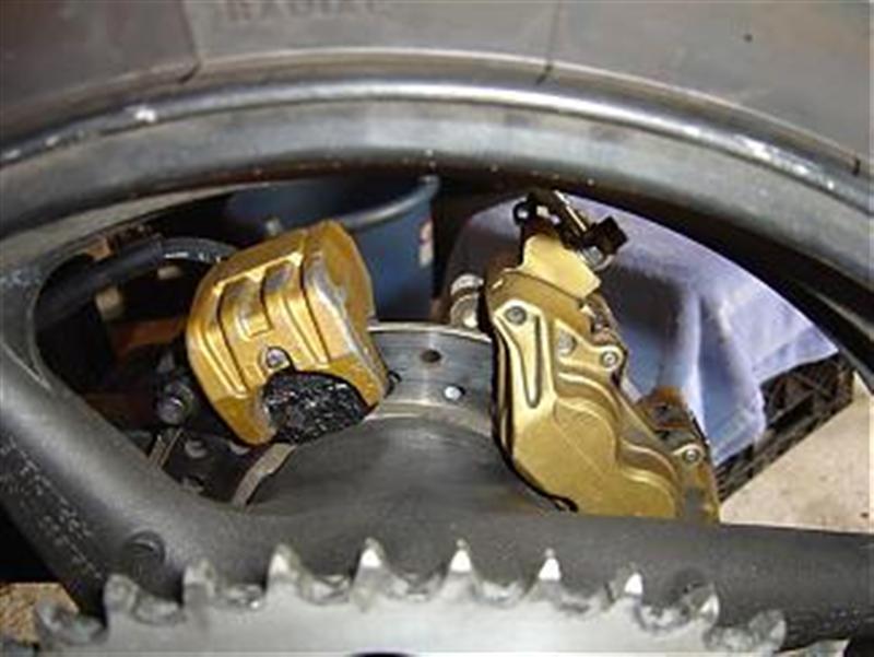

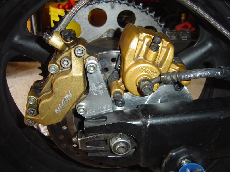

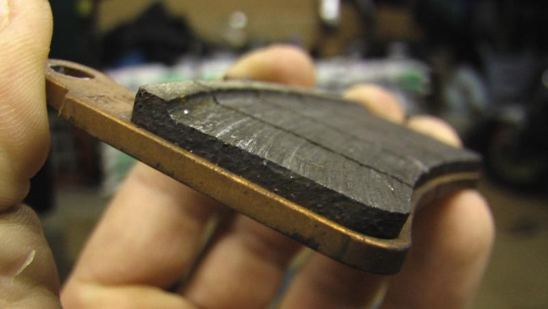

Just a heads up on putting a 4 piston caliper on your F4i . Now I am not saying it cant be done but you will have to trim your pads because the limited clearance. Check out www.hoheydesigns.com for OEM like style dual caliper brackets F4/F4i, 929/954, 05-06 600RR and 05-07 636 with more bike models coming soon.

Oh yeah I forgot to mention we already have out our first 03-05 model R6 bracket and I should have pictures later tonight to post up on our web site.
In 2 weeks we will be offering a combo deal bracket and 75" steel braided line for $250 shipped that’s Honda and Yamaha styles. For the flat style such as Kawasaki 636's and GSXR's they will run $225.00 shipped that’s bracket with 75" steel braided line shipped! Just something to keep in mind we understand that buying a good handbrake set-up doesn’t come cheap but we are working to keep the cost down so we can get our product to everyone for a reasonable price.
