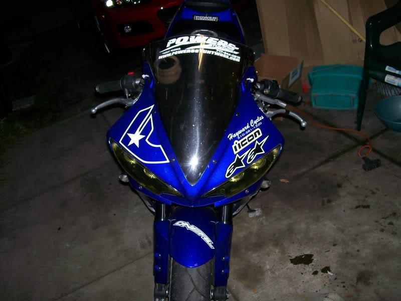

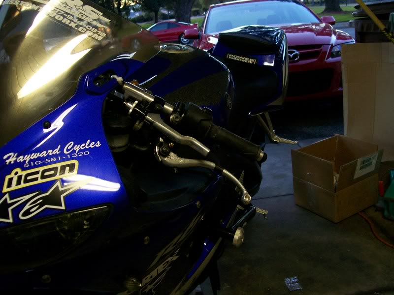

well, almost dont just need to get a SB line from you mayhem... then that is a wrap, and lets see if i can get some squid outta my system.

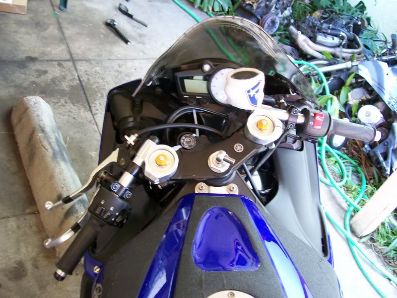

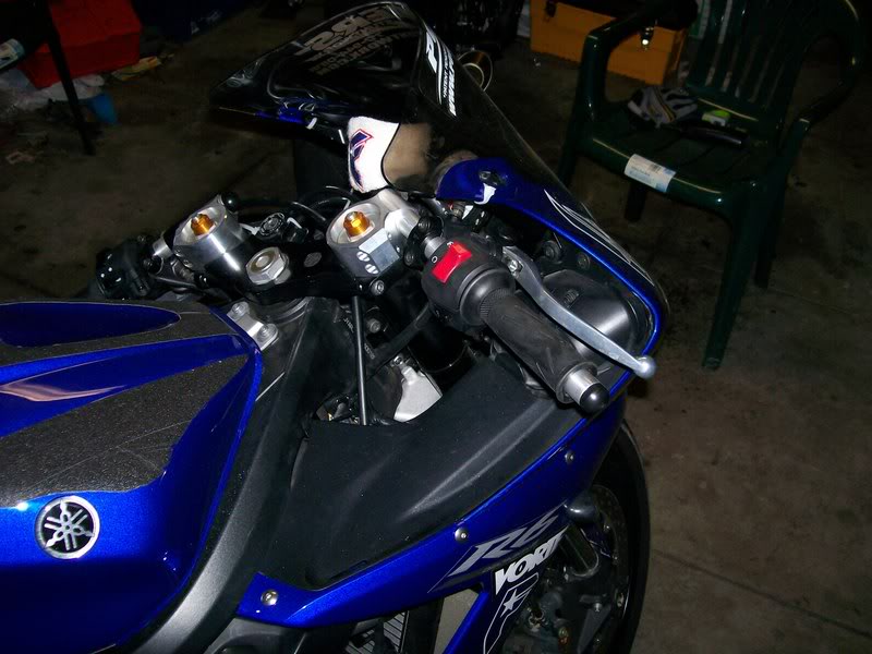

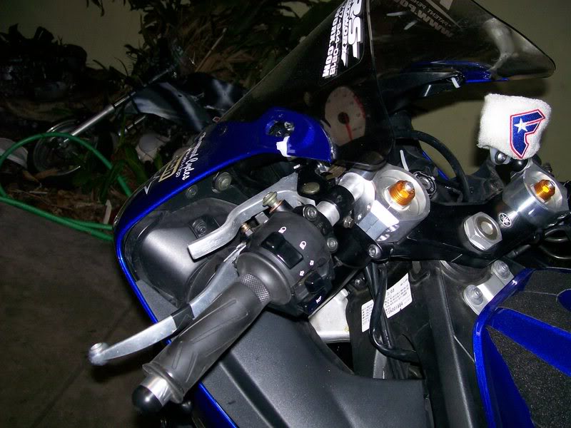

you can get those levers closer. i have the HB on the inside, tucked right up next to my ASV. might have to grind some of the stock perch off though.
i set em apart because i wanted to have that distance, i didnt want em right on top of eachother.
don't be skuured to bash the **** outa that minty tank..lol
lmao... i got a spare for that. and i need darius or someone else to do it, i never ever fucked with a tank.
i am about to cut the levers, and adjust the controls a bit more.... then put this baby to work!!!!

just make it so you can put your index finger on the clutch, pull it all the way in and cut it so you can work the brake with your middle finger while holding in the clutch with your index finger
right on...
i also left a little bit of room on my clipons for adjusting levers in and out later on like you said.

make sher that the master clears the headlight thats the same setup i have and make sher the clutch puls in mine hit the banjo bolt
check... and check.... made sure all those wouldnt be issues during mock-up.
nothing like getting somewhere to try it out, and can't... cause you didnt take the time to check clearances.

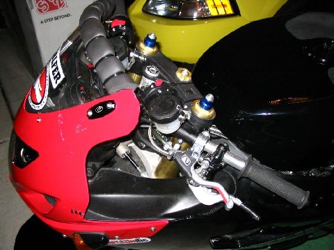

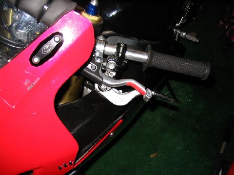

not that anyone cares, but heres my setup...on a gixxer no less...
woodys with msr and gixxer radial and FT rear master..
ID:	187034   Click image for larger version
ID:	187035   Click image for larger version

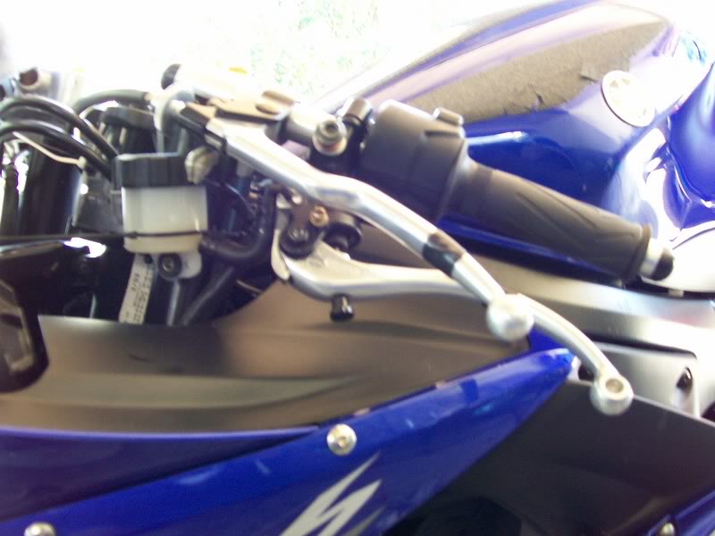

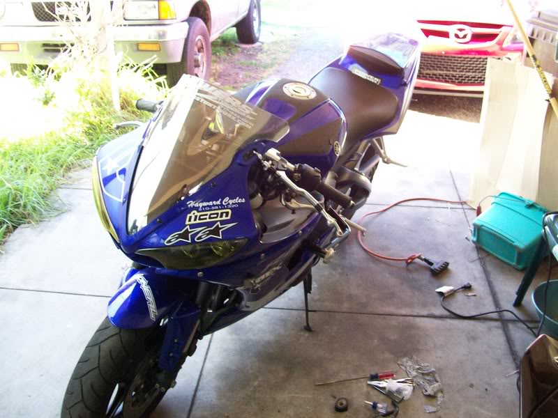

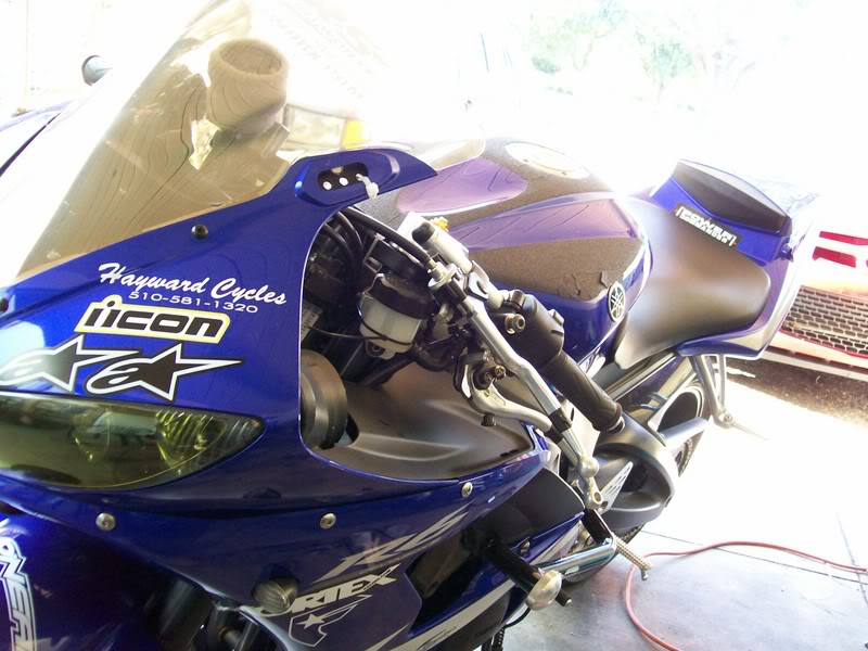

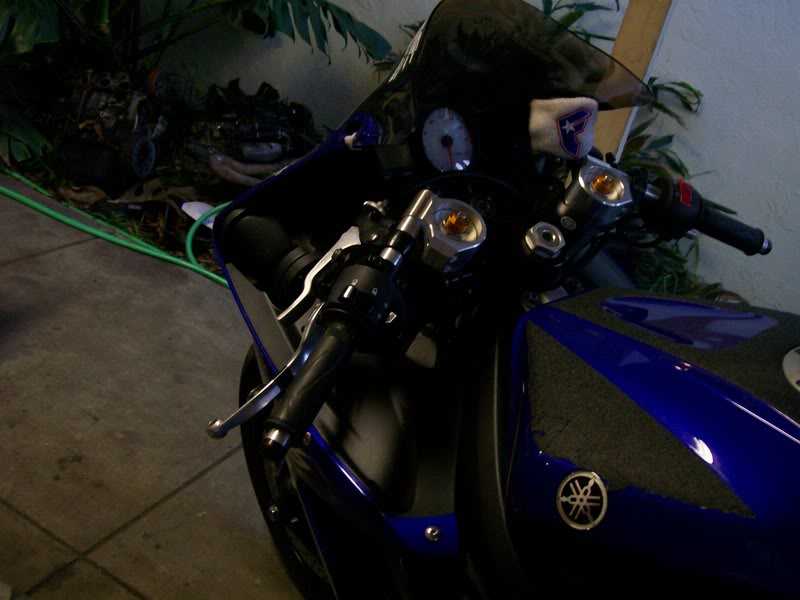

so i finished it all up, and asjusted my new clipons.... here is the final produckt, well almost... i still need to cut the brake lever.
why wouldn't you want them as close as possible?

Yeah man listen to what everyone is saying, your going to want that master as far up on the clipon as possible.....The way you have it you wont have the best leverage becasuse your finger/fingers will be too close to the pivot point in the master.....The father down the lever the more leverage youll get
