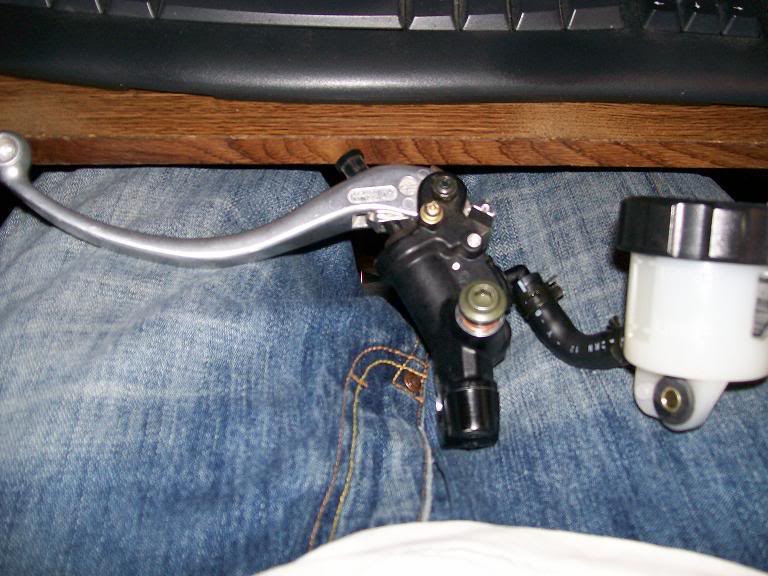

well, i was being stubborn..... but i will finally be adding a handbrake this week. i decided to toss it on there, well... because i started wanting to do other ****. ... beside standard *** wheelies that is.
i got a R1 rear master from a 2003, some vortex 50mm adj. clip-ons, and a 05 R6 radial master cylinder.
last setup we did like that was for my homies 06 R6s, and it worked out pretty good... but we used a standard master cylinder from a 03 R6, it came out fine.. kinda.
pics..
too bad the bike got demolished a few days later....
so... what we found out with that, was that the clearance was whorable for the stock clipons.... duhh and the clutch lever was mad high!! i didnt really get to experiment on it, seeing as thought it was my homies project.
well, now i am trying to see if i can make it look as clean as possible for mine... and try the newer R6 brake setup.
i am trying to bend the lever pretty good, but i will have to wait till i put it on the bike to see how i should chop it.

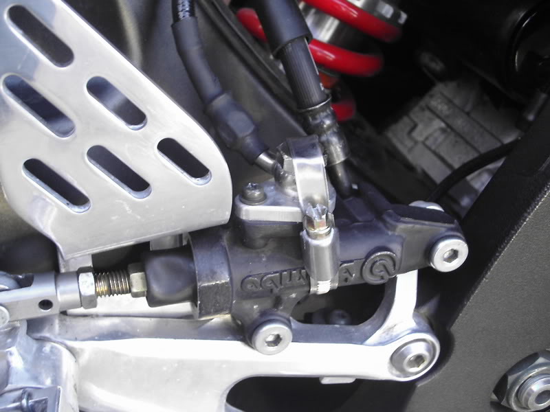

Once I cut my clutch lever I really like this position. Alot easier for me on the brake that far out on the lever. I do need to shorten the brake up just a tad, and bend it in another tad.

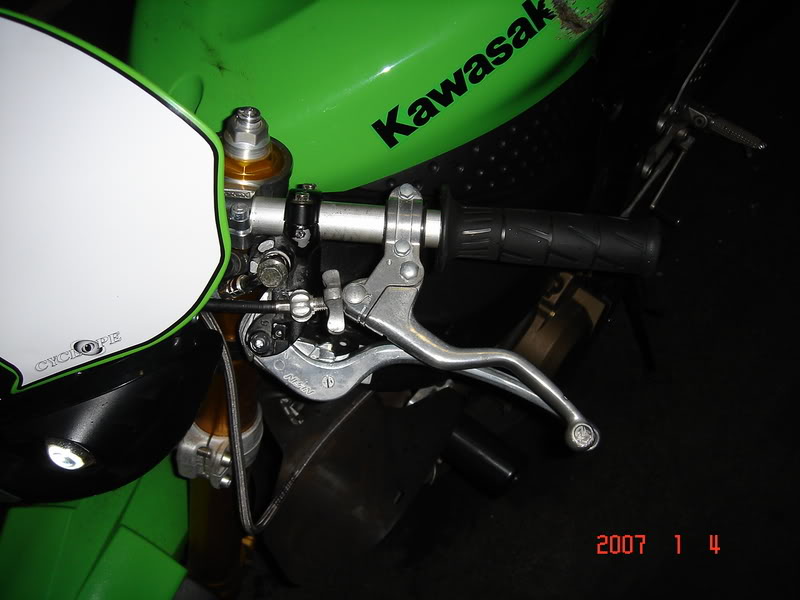

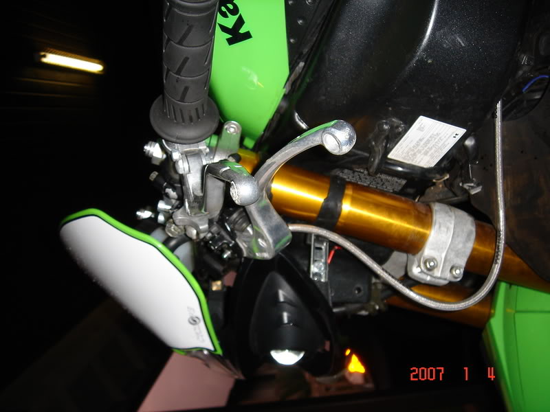

no scanner ...
stock clipons but turned out and flipped left to right
Old Jan 11, 2007 | 03:00 AM

Re: my handbrake thread..
i put them next to my guages still hooked up though
