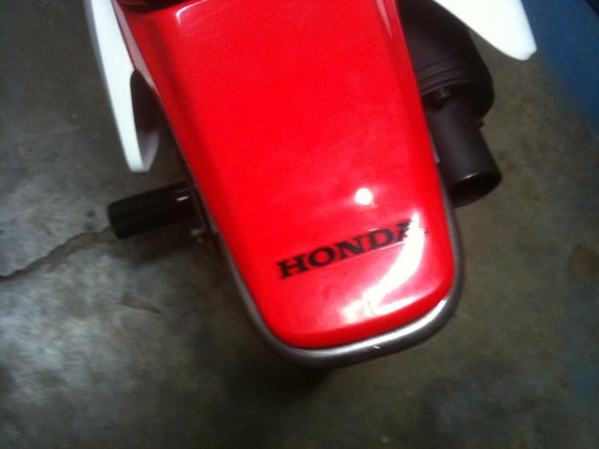

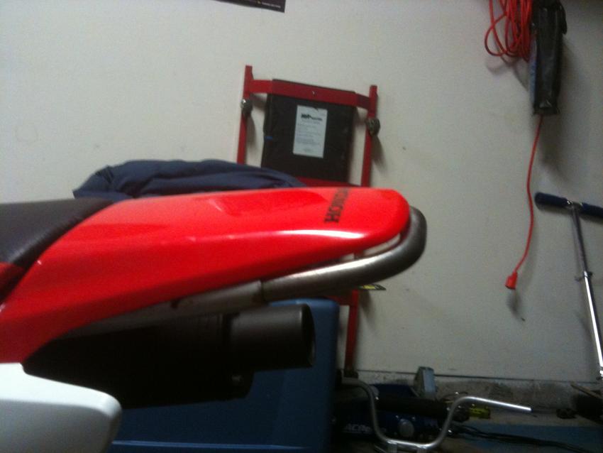

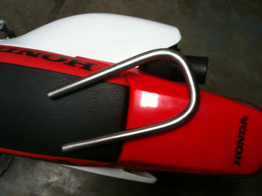

Made a roundbar to protect the rear fender, 1/2" solid steel bar fits inside the subframe (goes in 3"-4"). All you gotta do is slightly bend the subframe out and insert!! Once your done you can have it welded in permanently, comes unpainted. Price is $25 shipped, each one is made to order.

can i still run a 50 stunt 12 bar with this round bar intalled?

Yup, thats why i designed it so short!

Why would run both? Super duty Subframe?
I like it, it looks clean. If you mounted it like 6"-8 out from the tail could you get your foot in there for FIB tricks? or is to narrow? Props for a sweet roundbar.

It is 1/2" solid steel but i dont want to sell something that could possibly bend mid trick and **** a fellow stunter up!! The main purpose was just to support the sub frame and protect the fender, you could use 3/4" hollow and put it around the sub frame, but the hollow bar felt really weak..it didnt even bend smooth at the corners. I like the idea prickster has with his FIB roundbar mounted with the 50stunt brackets, im sure i could bend up something like that too.

Just keep in mind people...The farther the bar gets from the subframe, the easier it is to bend that subframe. Because it takes less effort for the ground to force it to tweak. Kinda like breaking a rusted up bolt. The longer handle u have on the wrench the easier it is to break that bolt loose....=-)

Exactly, more leverage!! Thats why i kept mine short and simple yet able to add the 12 bar kit.

Will it hold itself in place without welding? Also, I'm stoked about mine. When I put it on, I'll probably even throw on the new plastics I've had for like 4 months lol

Yeah it will stay without welding, i used a rubber malet to get mine in. I'm gunna have mine welded just for the extra support... should have urs by friday/saturday by what the mail person said.
