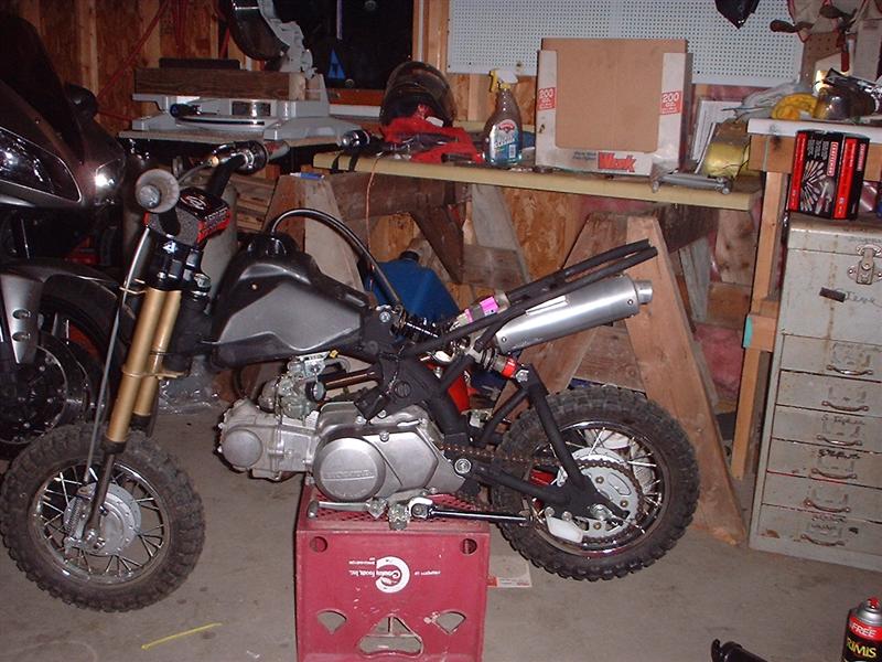

I moved my key to the left side behind the air filter in that hole. I just filed a groove for the key and popped it in.
I didn't cut the stock location off yet but i'm going to.

Re: Assorted tech questions..
A picture.

Old Sep 5, 2004 | 10:03 PM
Fuscat's Avatar
Posts: 838
cool, what air filter you running? Any complaints thus far with the key there?
