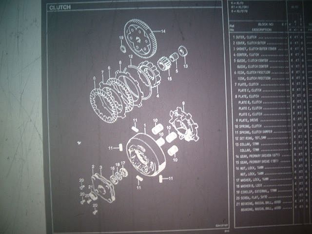

If someone can help me with the order I will write up a HOW TO DOCUMENT with pictures so it will make it easier on the next person
Here is what I did
1st = I removed all the stock clutch parts and gears
2nd = I installed the large gear next to #11
3rd = I installed the #11 on the back of #12
Question?
Under #13 I installed #10 first, #9, then the lock nut
Then I bent the tab onto the lock nut
On top of #13 I installed #7, put #6 inside #7, and then #5(spring)
If I have installed all of the correctly, where does #9 GO????????

Re: Honda Trailbikes Manual Clutch question
Question?
Thanks
you said you put 9 in already?????

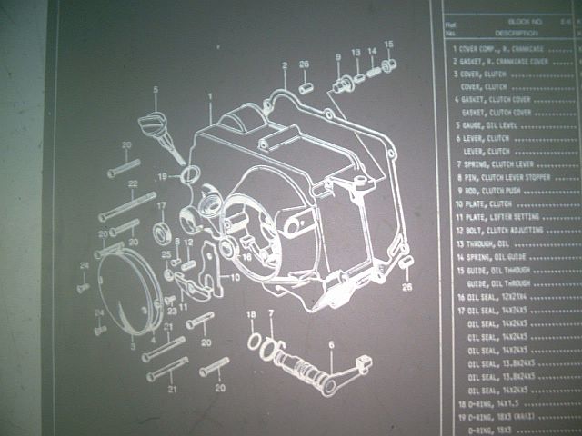

anyway for now take a look at these pics, and make sure you have everything as it is suposed to be..if you need bigger ones let me know...
[QUOTE=bigwhiteboy]here are the larger ones....
It looks like #13 in your picture is what I was referring to in mine as #9.
it goes under yer #11 gear. u most likely left the old one which is fine since its the same part.
Yep, that's what I did. Left the stock one on. I am debating on tearing it apart and switching them. I am not 100% sure it's there.. Better safe than broken.
