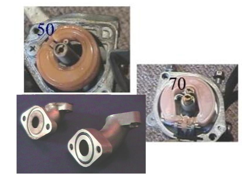

Xidium more octane makes you richer not leaner
your making the fuel itself richer by adding the octane
i dont remeber what carb your running ect ect ect
but your just riching it up to stop your knock
cheaper to jet the carb i run 13:1 0n pump gas no knocks either
although the 70 head it is true will flow more the squish band
shouldnt be that much different it isnt in the older bikes and i would guess it isnt in the newer i havent set them down and measured,but the 70 flowing more will make it richer
theres formula's around the net to give you a base line for what you should be runing on jet sizes you should have a 70 carb and intake so you can change both jets and yeah a 70 head would be good too the more flow the more go
by the pictures you can see the difference in sizes
