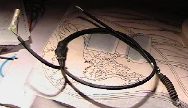

use a old stlye 50 cable from honda has the brake light switch built into the cable you just plug it in
thought it was for a front brake
if not my bad

i got this one at the honda dealer
cool so have you rigged it up and gotten it to work? does it just wire in-line to the brake light? (like a circuit i guess). and... is that a coloring book??

yes it just wires it into the circuit,you pull the cable closes the ground you have brake light,the older z 50's had these on the front and rear brakes

haha sorry bout that, but thanks for the info i'll check that out, is the brake cable plenty long? i have a bar kit w/ +1"s...

Yes , it will
the older bars were real tall
im gonna use it on my set up when i do lights
i got bars and 70 forks
plenty long enough for it
