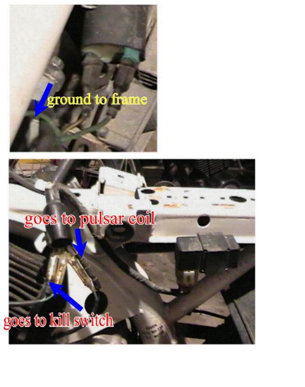

Re: xr50 electrical and other
ive got a late model z
they are the same
give me a few minutes to unbolt a few things so i can get a good pic for ya
just follow the color codes all hook to the same colors
green is ground on hondas

Thanks for those pics! I guess Im short a lil wiring. All I have it the module box lookin thing. The one thats like and inch, inch and half by half an inch or so. You go any extra's?
