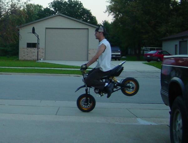

heres a quick pic of mine..... we sell them at the shop i am a mechanic at... they are cheap $$ and cheaply made..... but if your just gonna thrash it its worth it. a little mechanical ability and u can keep em running strong.. i order crf50 sprockets last week, and neither the front or rear will work..
i guess its prolly worth it to stick with the real honda!!! just my opinion though
also sucks as a stunter (except stoppies)

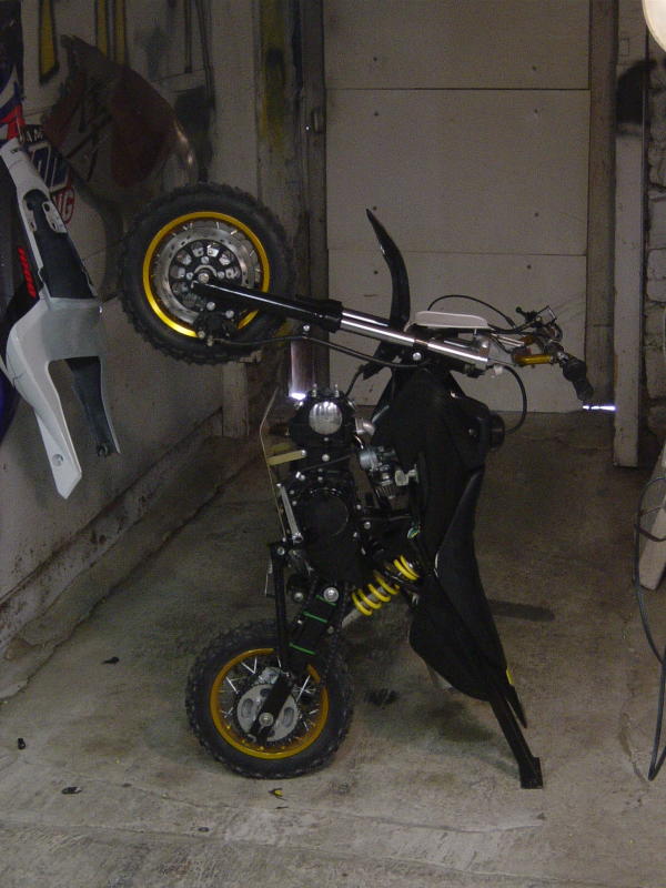

Originally Posted by Quicksta da RR
whats up w/ the hydraulic rear brakes, is there a way you can make a handbrake, (the same way you can for reg. stunt bikes)??
i used a hand brake of a 50cc copy quad the hand lever is on the left hand side and the hose is long enough to go to rear disc brake calaper cheap and easier than stock mod
