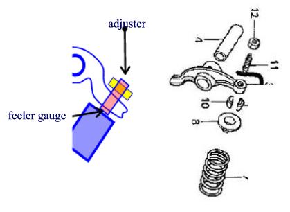

I finally decided I should check the valves on my bike. Almost two years of hard thrashing without doing it.
Anyone have an exploded view of where I am supposed to stick the feeler gauge? The little manual that came with the bike isn't to helpful. I can't get the **** to go in there like it should(I think).

should be very tight to get in, try using the side of the feeler. if you need a manual, pm me and ill hook u up

try this, when its put together, should go at the end of the tappet adjuster, no 11

fukt up, here ya go

that was a little unclear to me on the exploded view, and i know how to do it. i added a simple drawing for us simple minds hope it makes it easier to understand

Crap, that is where I was trying. Them suckers are tight. I need to get at them this week then. Thanks.

they should be kinda tight but you should be able to wiggle them with your hands
.002 is where they should be set thats kinda tight
and make sure you have it on the compression stroke or they will be really freakin tight.

Yup. I could wiggle them but just couldn't get the feeler guage in there. Huge 50 party at my house this weekend. Someone will know how to do them.

at the peak of the compression stroke?
Old Mar 30, 2005 | 11:49 AM
fab5fiddy's Avatar
Posts: 2,287
From: Cleveland,OH
fab5fiddy is a decent person
Re: Valve adjustment.
TDC compression

sorry but i don't know what TDC means.....
Top Dead Center?
