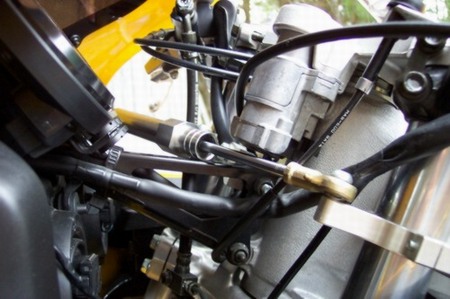

......not very clear but meassure from the bottom of the clip on

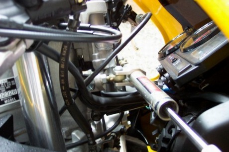

in this pic your rod may actually be closer to your ignition than mine in the pic,because I took a dremel to mine to give it more room...

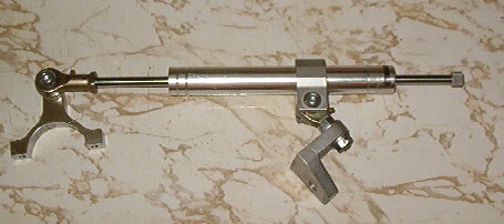

thanx for the pictures they're a big help. I think I know what my problem is. Check out where the clamp is mounted on my tube in the middle and yours is near the end. Do you think this could cause a problem?
Name:	resized damper.jpg

whats the total length of your damper tube in inches and I'll check this one...
Old Jul 16, 2003 | 06:05 PM
alltat2ed's Avatar
Posts: 69
From: Kingston, Pa
alltat2ed is an unknown quantity at this point
6 and 7/8 inches

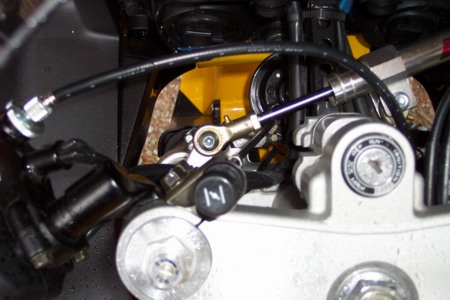

heres a pic with the steering straight

I just got your message. I'm gonna try it tomorrow with with it set up like yours. It looks like it makes more sense like that. The only reason there might be a difference is cause mine is a 96.I'll let you know how it works tomorrow. You were a big help Bro
Old Jul 17, 2003 | 06:26 PM
alltat2ed's Avatar
Posts: 69
From: Kingston, Pa
ok, I just got done test driving it with it set up just like yours and its F'ing perfect. I can't thank you enough bro. If you didn't post those pics I probably would have thrown the thing in the F'ing garbage. If you're ever in NorthEast Pa, you drink for free my friend. Peace
