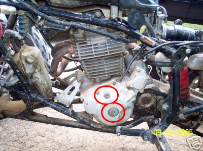

- remove the two caps on the magneto side of the engine.
* The smaller cap is a "peep" hole to adjust timing
* The larger cap is a 17mm bolt that turns your crank
- turn your crank counter clockwise until you see a "T" mark through the "peep" hole. There's a little notch inside that peep hole that you need to line up the "T" marking with. This means that your engine is at "TDC" or Top Dead Center. However, there is two TDC's on all 4 strokes.... a compression and exhaust TDC. The compression TDC means the piston is at the top of the cylinder getting ready to compress down and make power. The exhaust TDC means the piston is at the bottom of the cylinder getting ready to push up and release all the burned gas. You want to have the engine at the compression TDC in order to adjust your rocker arms. Here's how to tell....

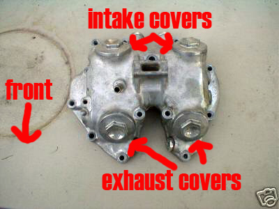

- remove the 4 rocker arm covers located on top of the motor.

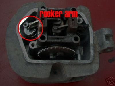

- using a 10mm wrench and flat head screw driver, back off the retaining nut on top of the rocker arm and screw down the adjustment bolt.(the picture showing rocker arms is from an older 4 stroke with only 1 rocker arm on each side. The EX motor has two on the carb side and two on the header side.)
- once you've got the adjustment bolt tightened down all the way, back it off just a hair and re-tighten the retaining nut. Now you should be able to only move that rocker arm up and down about a "**** hair"... just enough to feel it clicking when you jiggle it. The proper adjustment is like .400 using a feeler gauge, but those dont work well because of the access you have through those 4 holes on top of the motor.
- repeat these steps with all 4 rocker arms.
