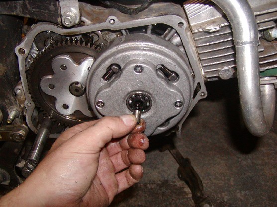

I just installed my manual clutch and I have one ppiece left Does anyone kow where this goes? Also 1 bolt doesn't fit as in it's not long enough to hit threads on the side case, it's the bolt hole with the clutch cable holder. I've tried all the bolts and no luck.

DOOD!!!! dont start that thing!!!! that is the bearing for the gear that slipts on the crank under the clutch. pull the clutch off and then pull off the small gear. it slides into it. pm if u need help

Finally a man with some knowledge.... Thank you very much.
