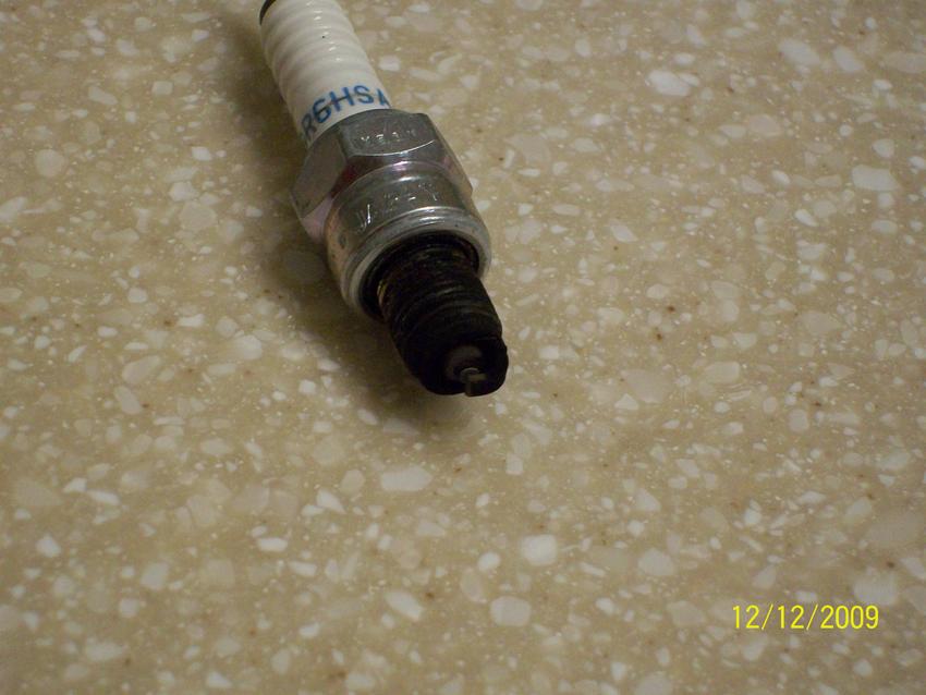

hows the spark plug?
Old Dec 12, 2009 | 11:12 PM
99CBRXX's Avatar
Joined: Aug 2009
Posts: 97
From: lecanto, FL, USA
99CBRXX is a decent person
Re: Stock 50 Idles high & Sluggish
It's kinda grayish brown around the electrode with a bunch of soot all the way up the threads.

Old Dec 14, 2009 | 02:26 AM
XRshfifty's Avatar
Joined: Feb 2009
Posts: 319
From: Portland, Or, USA
XRshfifty is a decent person
looks like you're running too rich, or the plug is too cold.
Old Dec 14, 2009 | 12:24 PM
99CBRXX's Avatar
Joined: Aug 2009
Posts: 97
well i did the stock air box mod the other day and that added some power, evened out the powerband and made the plug look a little better....but i have run out of ideas on how to get it to idle normally...
