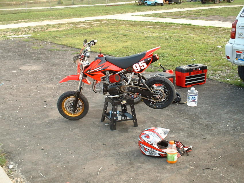

Ive got $8000 in mine but the only stock parts left are the wiring harness, a few bolts, and stock cases.

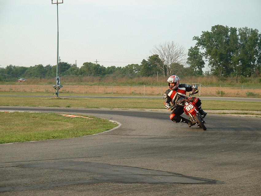

Re: cost to build your fiddy
heres a pic of circleville raceway. I have some Mid ohio mini gp pics from this past september but I am having trouble resizing them. I will say wear all your gear. I had a buddies front brake lock up on me on his prc108 and broke two ribs,and my collarbone this past summer.

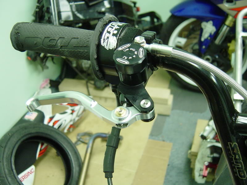

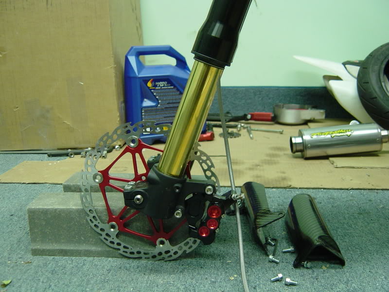

Thanks I was asking about the HOPE brakes because Im also using HOPE componets on my 50....Should have my hub and bracket back from my machinest on monday....Close to your setup but Ti6 caliper and 203mm saw rotor, also using the pro lever not the standard one...
