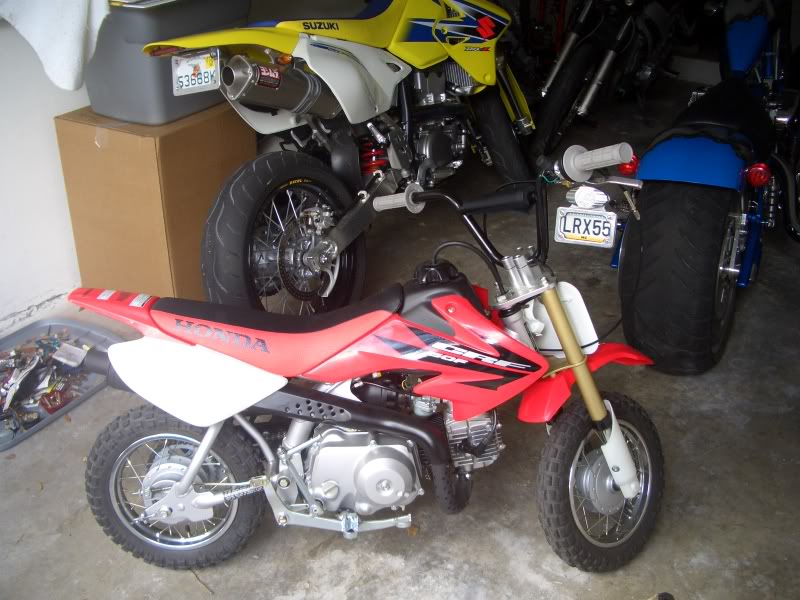

og ryan lee's Avatar
You seen Philo Beddoe?
Posts: 859
From: Oral Springs, FL, USA
og ryan lee is an unknown quantity at this point
Re: cost to build your fiddy
I just bought it last saturday and changed the bars on sunday... 1200 plus tax and 160 for the bars

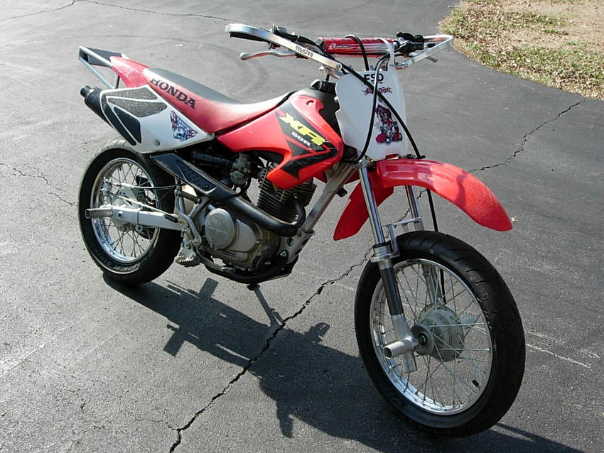

You guys have some of the coolest ****** fiddys ive seen (but I dont see alot of fiddys) Anyways .... I've sat on 50's and 70's and they are both too small for me .... I'm riding and learnin on 80's and up.....
My opinion is that an xr or CRf 80 is better than a fifty.....cause it is just a little bigger to handle an adults size and weight better ....and it has a true clutch....(clutch it up skills to be learned here)
I've got 3 80's and an xr100 and none of them costed more than $1000.... the cheapest 80 I bought was $650 !!! and needed nothing but a good going through (oil change, brake adj, cable adj, chain adj, spoke adj. etc.)
basically for about $4000....I have a practice bike, a play bike...and a couple spares for friends or in case i blow one of them up or somethin' :YEAH

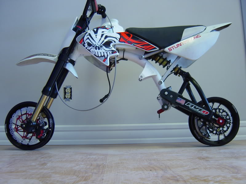

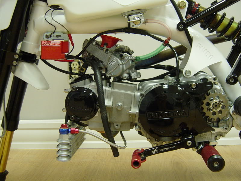

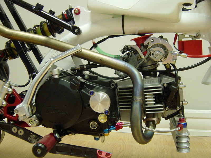

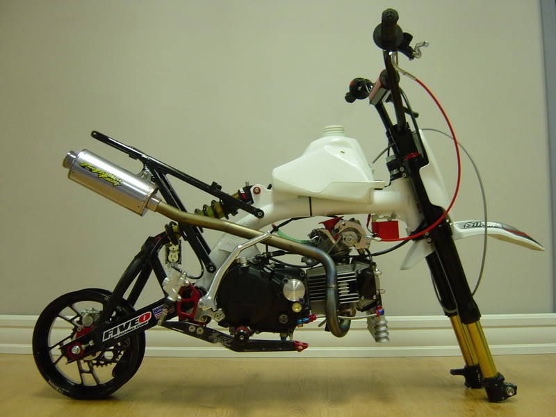

The cost of mine just went up a few thousand
New parts
Keihin FCR 28 downdraft carb
Takegawa 5 speed
Takegawa 124+R bore kit
Hope Mono Ti6 caliper w/203mm floating rotor and radial master
Billet wheels
white gas tank
Originally Posted by killinthafiddy
damn johnny u need to post up on fiddylife
Im guessing there alot of street 50 riders on there? Im on Planet minis and 50 Riders but those are both mostly dirt riders...Gonna sign up right now and check it out thanks
Old Feb 15, 2007 | 09:50 AM
  #39
nyRocketkid's Avatar
Posts: 2,698
From: ..
Looks better ever time I see it bud! Those wheels are sik too! & Whats your new top speed with your new tranny?
Old Feb 15, 2007 | 10:04 AM
  #40
JohnnyP's Avatar
Posts: 3,289
From: Toronto
JohnnyP is a decent person
Theres a guy on planet minis that has lots of experience with Takegawa
124's and some good info, he did some calcualated estimated speeds for my set up..Heres what he came up with..
"For example purposes here, we'll use your 16/36T rear sprocket.
At 10,000 rpm, this will be the mechanical max speed in all gears if your motor has the horsepower to push it.
1 - 26mph
2 - 38
3 - 52
4 - 64
5 - 76
At 11,500 rpm with the same sprocket combination
1 - 30mph
2 - 44
3 - 59
4 - 74
5 - 87"
