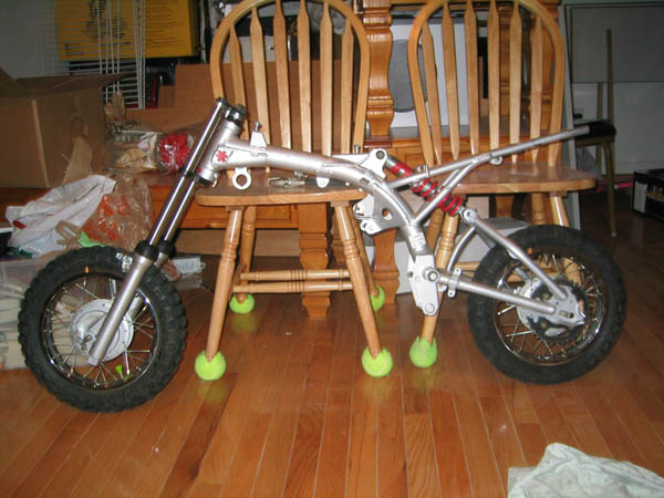

here are some pics..im done for today, kind of tired.
after an hour of grinding...here is the frame work. all i have to do is bolt and align...mount the motor, bars and plastics...oh and i need a master link for the extended swingarm.
only problem i ran into was the swingarm and the brake stopper. thats easy, just drill a hole and put a bolt through...
later! damn tired! ill post when its totally done and then ill ride it and tell you guys whats up.
i need a LONGER SHOCK!!!

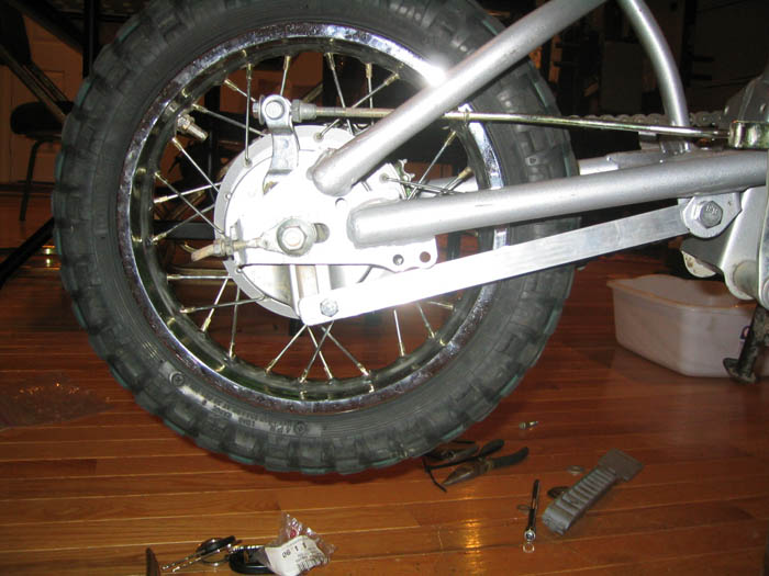

aight so the bike is almost complete. dropped the motor, should have cleaned it before i put it in but i was lazy.
THE HARDEST thing was the rear brake...boggled by how i was going to fab a stopper...so i made the easiest one possible. take a look at the pic
overall the bike is coming along and the setup looks to be coming out good. still havent gotten a chance to ride it but itll be done by tomorrow.
all i need is a front bicycle brake cable and im straight.
take a look at the pics and tell me what you think. :YEAH

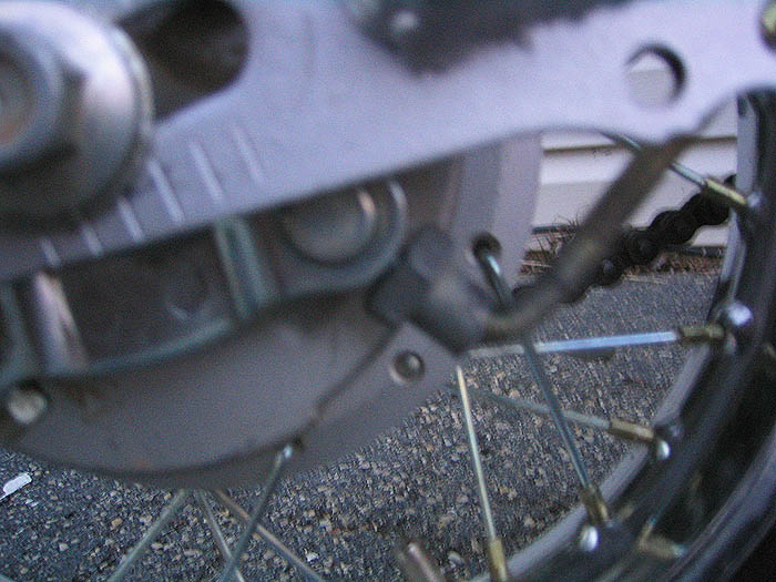

yea i had a interesting ride today...the rear brake stopper was a total failure lol! take a look at the pics...back to the drawing board. anyone have ideas for a stopper?
yea otherwise the bike ripped. and the with plastics on it looks great.
HOW DO YOU FAB A REAR BRAKE STOP! otherwise this fab was a total success...

if u have a welder or access to one, just weld a little bolt or somthing to swingarm for the brake stopper
