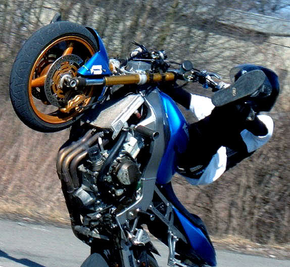

u can see half of it there. the polypropylene sliders aren't in it on that pic. the front engine mount is where the slider will be and it will hit the groudn the same time the back does. making 2 contact points with the contact point on the front engine mount being the slider so its easier on that weak area of the frame. the back is a plate mount that ditributes the hit load over the frame spar so its easier on teh back bolt as well
you can kinda see the back plate im talking about here
so if it does pivot it will pivot upward on the plate and also pull the rail/plate on the other side of the bike since they are bolteed together through the swingarm pivot.

damn homie that was quick! but leave the glamma pics for another thread... lets see the CAGE!

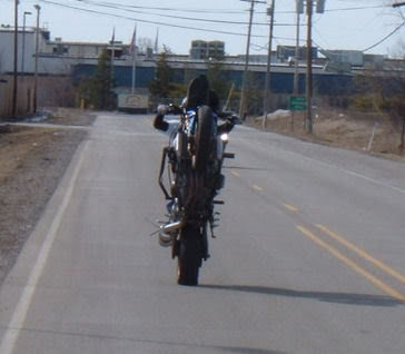

That's kinda what i was thinking...... my cage works.........

trick tested Stunter approved :YEAH if it's just 2 sliders instead of a race rail like you were talkin bout... it's not gona hold up even if it's just those 2 sliders, and connected.. they bend upward, and you have to cut the cage off (i had one) it bent upward, and then the stator cover would hit
