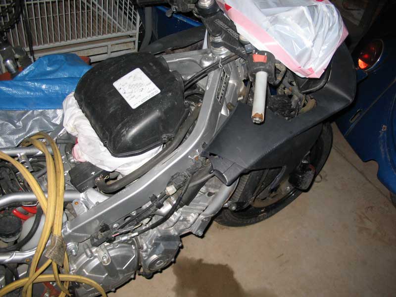

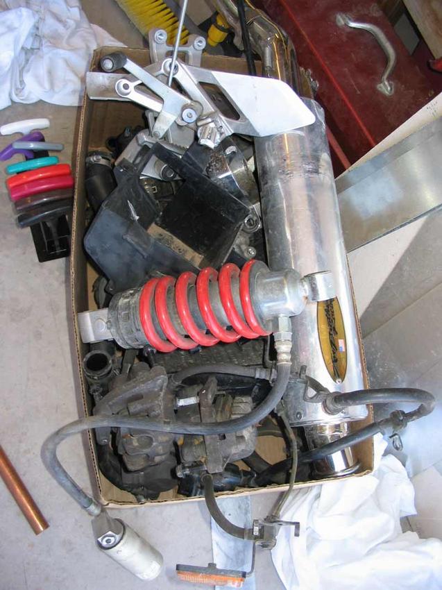

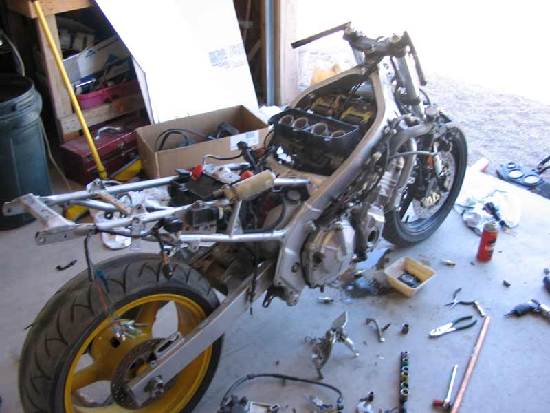

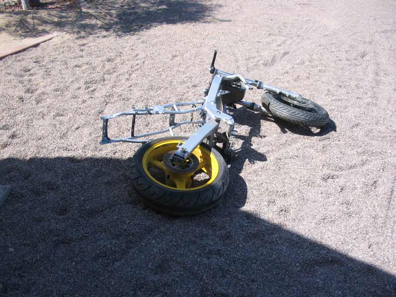

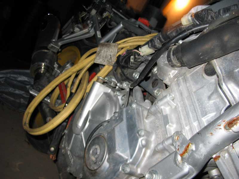

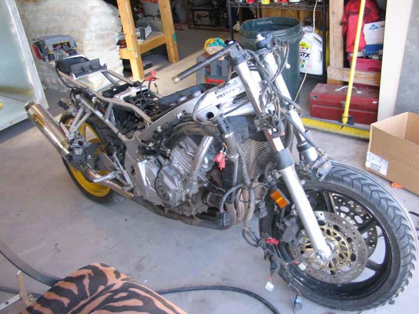

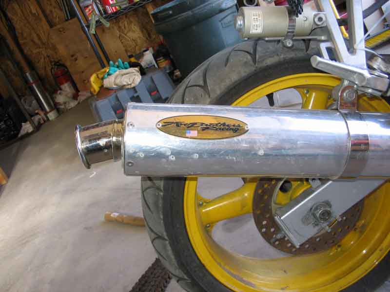

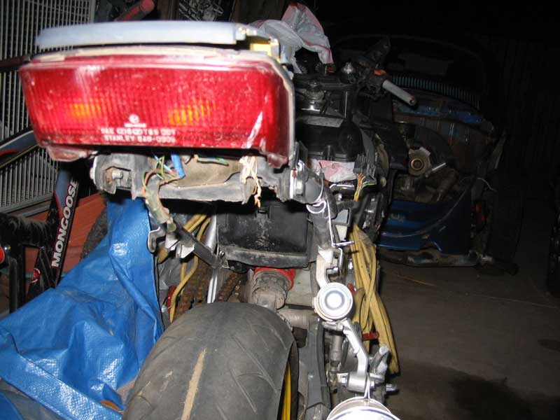

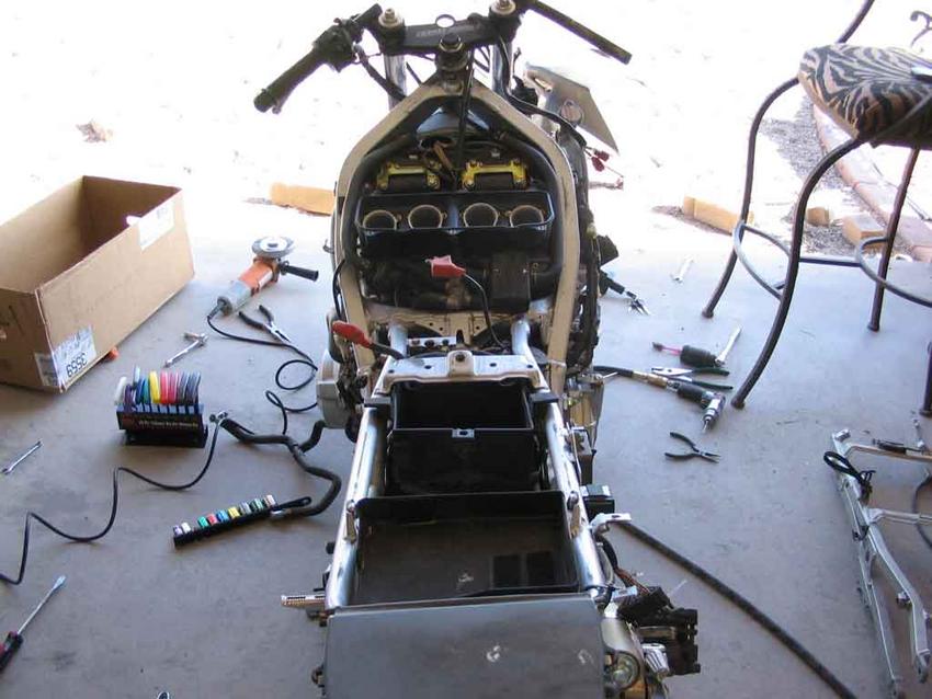

Day 1
The first two pictures are of it when i first seen it in my friends back yard. it has been sitting for about 4-5 months now. the rest the pictures are tear down beginning

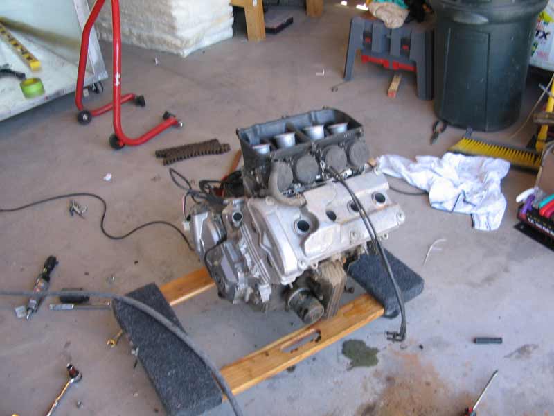

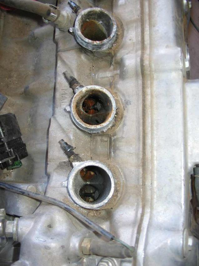

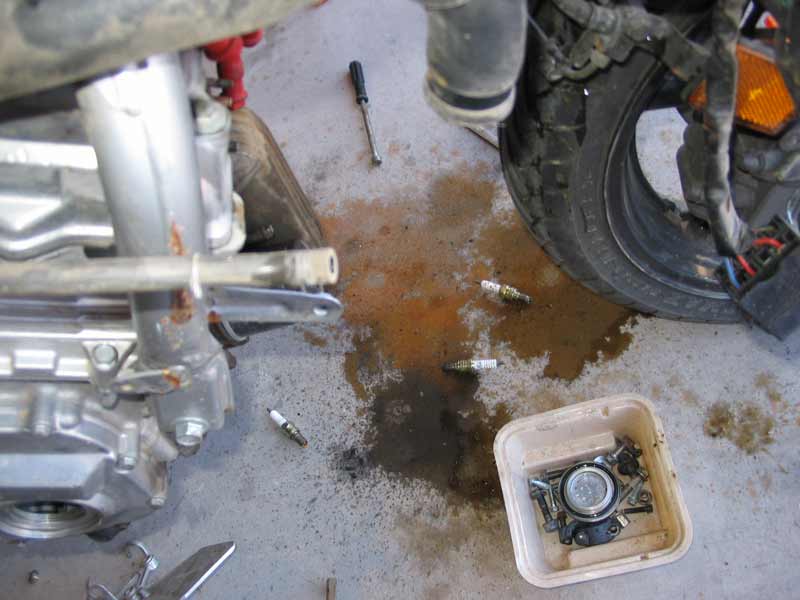

day 2,
So i was like alright ima try n see if i can spin the crank manualy from the lower timing cover bolt.. and well that didn't seem to work so i was like **** it throw in a battery real quick and hit the start button... well i pulled the plugs before trying it manualy so theres no compressor making it difficult and now that i had a battery hooked up the start will turn her over, so i started hitting the start button and i could hear the starter clicking. after about 15 trys it finaly spun the motor and oily/gasey/rain water shot all over the garage n ****... its a honda a motor so you know this aint **** lol, but she turns over smoothly now and i know shes got good rod bearings.

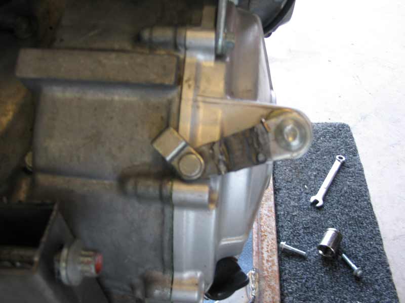

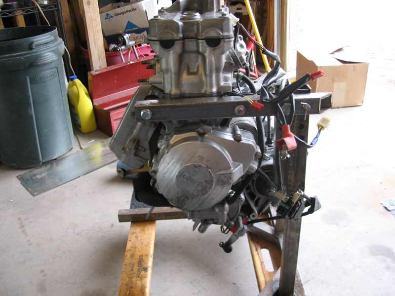

Day 3, friday, april 20th...
made a alittle engine stand from scrap metal real quick and
Pressure washed the motor and got it all cleaned up. i also extend'd the clutch puller arm 1/2inch

Nice EZ pull mod

Originally Posted by Ho_Hey
Nice EZ pull mod
Yes sir, **** took 2 minutes... can't wait to feel it, i will be running a moose ez pull clutch with it to maybe, or an asv... im undecided ATM, i am adding 3/4s inch on my 05 636 monday that i allready have the moose ez pull clutch lever/pearch on, ***** going to be 2 easy to pull in

Old Apr 22, 2007 | 04:55 PM
Re: Project F3 Fighter
i think with the ez pull and the lever mod there will be so much travel at the lever you will have to pull it to the bar to get it to release and you may run out of adjustment ...the easy pull and the mod both make it easier to pull by increasing the travel at the lever..jmo
then its going to get an ASV
