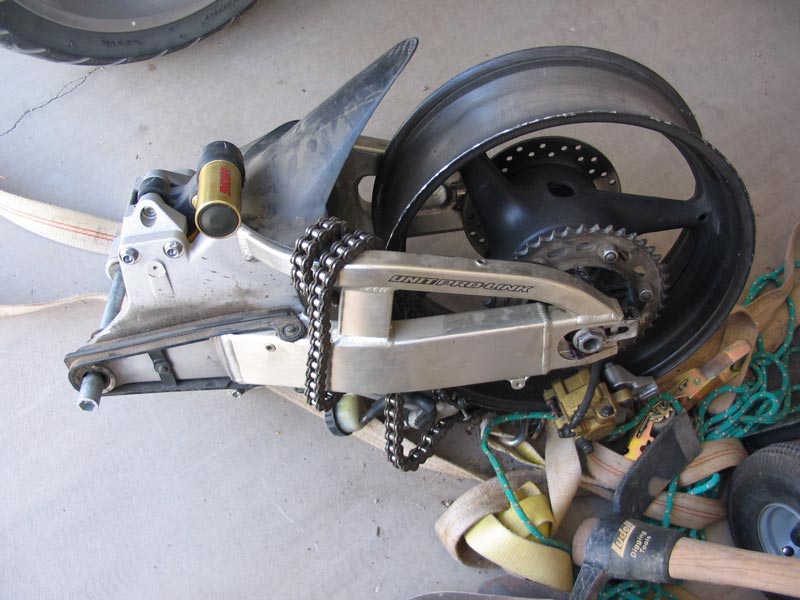

its getting a 2004 600rr unit prolink swing arm and 6inch 954rr Rear Wheel
swing arm will be powder coated super wet black, wheel will be powder coated gold.

Old May 3, 2007 | 02:53 PM
Z-UNIT's Avatar
Posts: 6,124
From: wherever willie is
Re: Project F3 Fighter
how the fucck are u guna make that work

Old May 3, 2007 | 03:21 PM
Wheeliest's Avatar
Scrapes Elbow
Posts: 8,833
From: Phoenix, AZ.
i know the stem is same length as 954 tripples, but the bearing cups/races are dif size so you gotta use f3 bearings. and for the 600rr swing arm, i will have to shave down the swing arm on the right side, and weld new shock linkage tabs to the lower frame brace, and have a special pivot rod made for the swing arm due to the dia is larger on the stock 600rr pivot rod then the f3, its alittle bit of work but its going to work. it should be mounted and good to go by the end of next week, this bike also just got a pair of 06 600rr forks., so her name now is F3RR

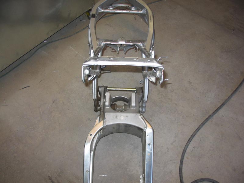

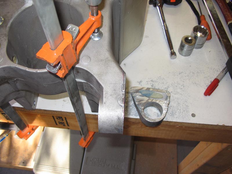

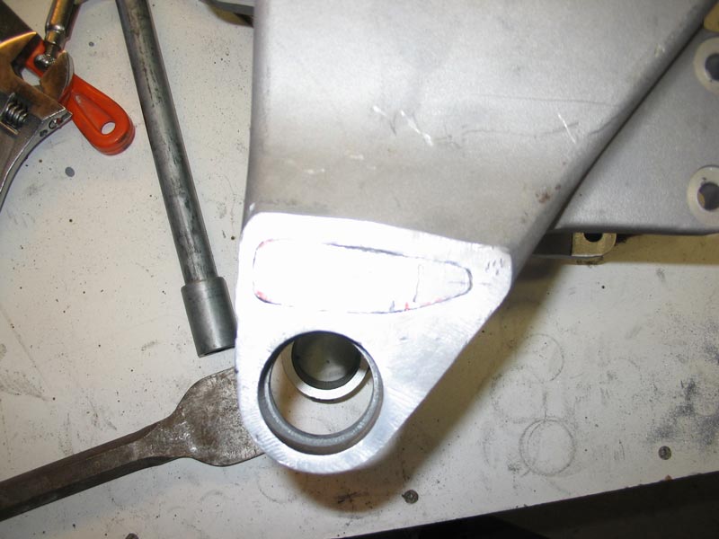

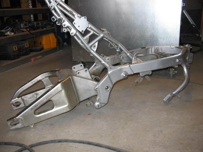

Old May 3, 2007 | 10:13 PM
Wheeliest's Avatar
Scrapes Elbow
Posts: 8,833
From: Phoenix, AZ.
ok well heres new pictures, removed all the bearings, cut the swing arm down to fit in the frame, made a filler plate. ima take it to get welded in the next day or so...
