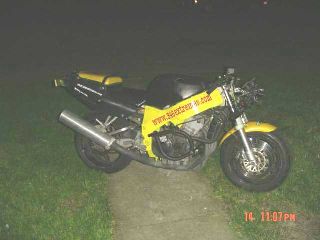

how to set up a ghetto *** stunt bike
re-enforce the frame by welding 1/4 incdh thick aluminum behind the entire frame, fill in the little trianles in the main beams with 1/4 inch thick aluminum plate, beat the **** out of it and buy a new one (new to me) everyseason. lots of zip ties and a good tap and die set help. rhino liner the tank so you dont slide off during balanced spreaders. custom bungee cord seat holder, custom zip tie tail light mounts, cut stock pipe down 3 inches to avoid running that long bitch on the ground during 12's, a chain attatched to the triples and the key to hold it in during crashes, cut all the wiring you dont need, cap it off and tuck all the wireing under the tank(avoid searcing for that wire you ground down when you yard sailed it the night b4), rags around the leaking fork seals, cut brake and clutch lever down so you only use 2 fingers on them. turn fuel petcock so you can still get to it after you re-enforce the frame, 1 inch tall spacers under the tank mounts(after you dent the **** out of the tank it bends in the middle and knocks your air box off constantly...)

"re-enforce the frame by welding 1/4 incdh thick aluminum behind the entire frame,"
pics? sounds pretty agressive for 900RR?

i have a couple pics of the triangles and the motor mount ears

:YEAH I'd do it, my buddy looped his 900rr yesterday and broke on of the motor mounts on the frame clean off.
Must suck checking and adding coolant.

sounds like you dont know alot of 900 stunters yet. Those things crack like hell near the triangle.
naw, you can see it from the back, you just put zip ties in place of the screws, when you need to add, you cut the zip ties and tip it back. besides unless you have something seriously wrong, you shouldnt loose antifreeze anyways. i never have
