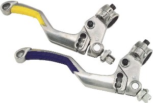

Buy one of these. I love mine and it is two finger compliant..... I got mine from a local shop for $32. Best 32 bux I ever spent on my bike.
http://www.mxdeals.com/detail.asp?product_id=34-1805
Cable lube and spray......
http://www.instantop.com/CyclePage/ChampionsChoice.htm
will these levers fit on a regular clip-on or for MX bars only?
mx bars and regular clip-ons on the same size....so yes
