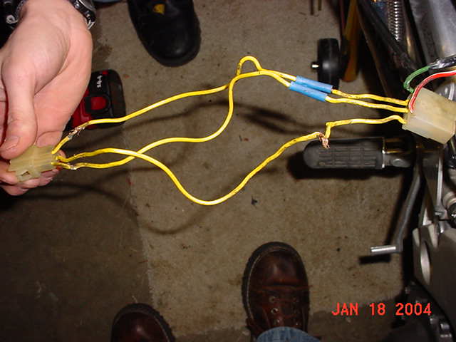

Ok heres the deal I just bought this 900RR stunter and am in the processes of fixing it up. I took it out of the garage today started it up and was letting it sit and warm up. About 5 minutes in I notice som smoke and go check it out and the rectifier is smoking. WTF?? It started up and ran for a few minutes before I bought it and nothing like that happened. What do you guys think and have you had any rectifier/regulator problems?

was the thing bolted on when you started it? i know they have to be grounded, looks like the harness is tore up, you should repair that, hit me with a pm ill explain more detail. i have had problems with rcet before.

I've had a problem with those on my F2 & my 900RR.
Make sure the harness is not all burnt up and the wires going to the harness arn't melted together. Mine were all stuck together, so I fixed all the wiring and heatshrinked each wire...Haven't had a problem since...Well, I did have to put on a new regulator.
When you get a new one, get one that has heat sinks on it to keep it running cool.

Alot Of Times The Honda Plugs Get Hot And Melt. Not A Big Deal Fix The Wires And Replace The Rectafier. Check The Stator And Make Sure That The Roater And Stator Are Not Out Of Round And Touching From A Prev. Wreck.

Sweet sounds like everyone has had the same problem, the wires going into the rectifier were definitely melted together, I pulled them apart and taped them up before I started it up, but they were pretty chawed so it'd probably be best to rewire the whole thing. My guess is the damage was done when the previous owner had it and the rectifier just finally gave out when I got it.

Go to the parts store and get some heatshrink! Make sure all the wires are butt connected REAL good, or better yet, solder them together and heatshrink all of the wires seperate. Don't use electrical tape, it doesn't withstand the heat from the wires and will cause them to melt together again.
Good Luck and like I said earlier, get a regulator with the heat sinks built into it.

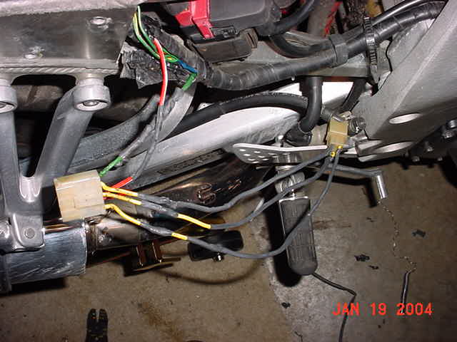

Re: 900RR Problem (Rectifier?)
Originally Posted by SteveR6
ok, soldered and heatshrunk all those wires. Now I just need the new rectifier and it should be good to go. I hope.
Looks like you'll be good to go..
