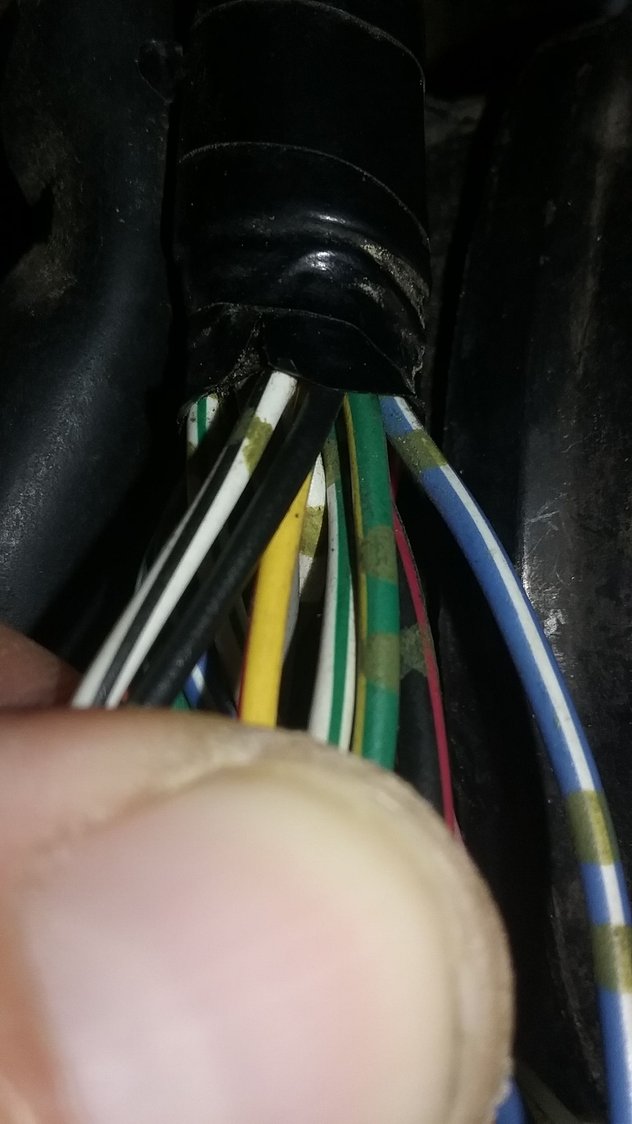

I am having a hard time wiring up this missing switch, well the lack of the connector to the harness was gone when I got the bike. What I would like to do as I am not riding it very soon is to wire it up so I can run it. The closest I have gotten was tach and lights on then try to start only relay clicked. I am starting over hoping someone can let me know which wires connect to which. I tried what I thought which was for the Run / Kill switch was black & white/black stripe then I tried the yellow/red stripe, black, black/red stripe, & blue/white stripe as I thought the diagram below was telling me. And I believe the white/green and green/yellow are for lights
I have a good battery, I have bypassed the bank, kickstand and clutch sensors. Checked fuses. For some reason, I can not wrap my head around how to wire this up. First Honda is proving for me to be the most difficult. If I need a toggle or push button temporarily I have those. The bike is not stolen or has at least never been reported as a recovery I have a hard time wrapping my head around why someone would chop up one so bad. It is also missing the ignition. I have a picture of vin number plate if needed for validation I understand that this is my first post and just registered today. Out of most forums, I have found the answers to most of my questions here but I am no stunt rider. I do not plan on leaving it bypassed like this and understand the safety concerns. Thanks in advance.
What I am working with.
Yeah I have 1/2 of it
