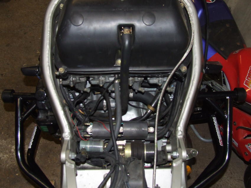

i got an old 98 zx6r ,anyone know how to to the air box mod on this ? heres a pic of the bike.any help would be appreciated!

yeah ,do you know if it can it be done on this bike ? i know theres lots of info for the kleen air mod for f4is and 636's but searched and could'nt find nothin for this bike as hardly anyone rides them now,but im assuming something would still need modifying to stop oil getting in the airbox .

that big hose on the back of the air box is probably your crank case vent tube , you will probably have another hose close to the same size coming out the front of the air box ..
connect those two to bypass the air box and then disable the pair valve , the pair valve will be the t conector that the front hose off the air box is connected to ..
the pair valve will either be vacuum operated or electric, if it's vacuum operated disable it by unplugging the little vacuum line and plugging the line , if it's electric just unplug it ...
when you are done cap off the two holes left in your air box from the two hoses you disconnected ..

just wondering is this right? ,i cant find my workshop manual so im kinda guessing to what the tubes are, so i basicly i connect B (crankcase vent tube) to D , then disable pair valve (which im guessing is A) by unplugging and blocking C which im guessing is the vacum line .then block of the hole were the D hose went too.
yep sounds like you understand perfectly but block both holes left by hoses b and d
