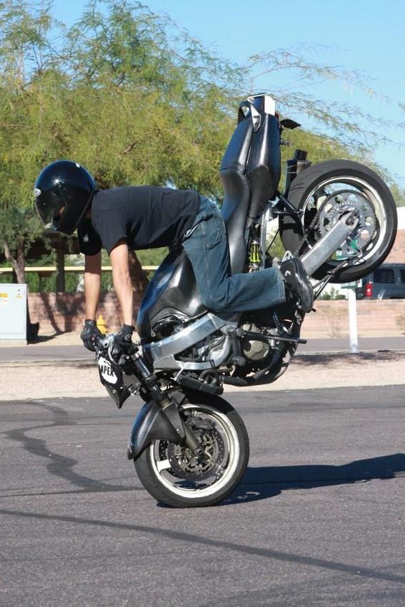

its 1/4 aluminum plate,cost me 80 bucks to get done

cool, so you just put that little plate on and problems solved? seen a picture of someone who had the whole area filled in also do you know who has that done? did you have a little hairline crack right at the weld...

yeah I had a crack on one side that was pretty long,like over an inch and was starting to work its way to the main support,so my welder welded the crack and added the plates.That was about a year ago and Ive had no problems since
wondo has the whole gap filled in and its all polished,**** looks badass
